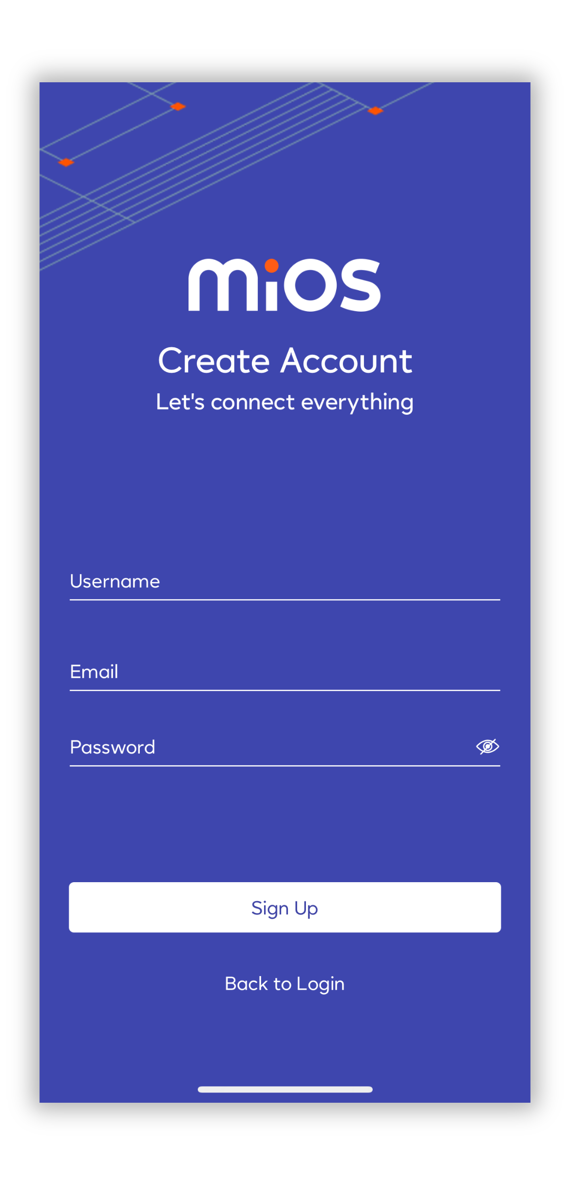

  • Open the MiOS app and accept the access permissions for the app
  • Tap on the message "Don't have an account? Sign Up" and follow the on-screen instructions to create a new account
    • Add the Username you want to use for the account
    • Add a Password that is at least 8 characters long and has a combination of capital letters, lower cases, numbers, and special characters
    • Add an Email that you have access to so you can validate the account then tap on the Sign Up button

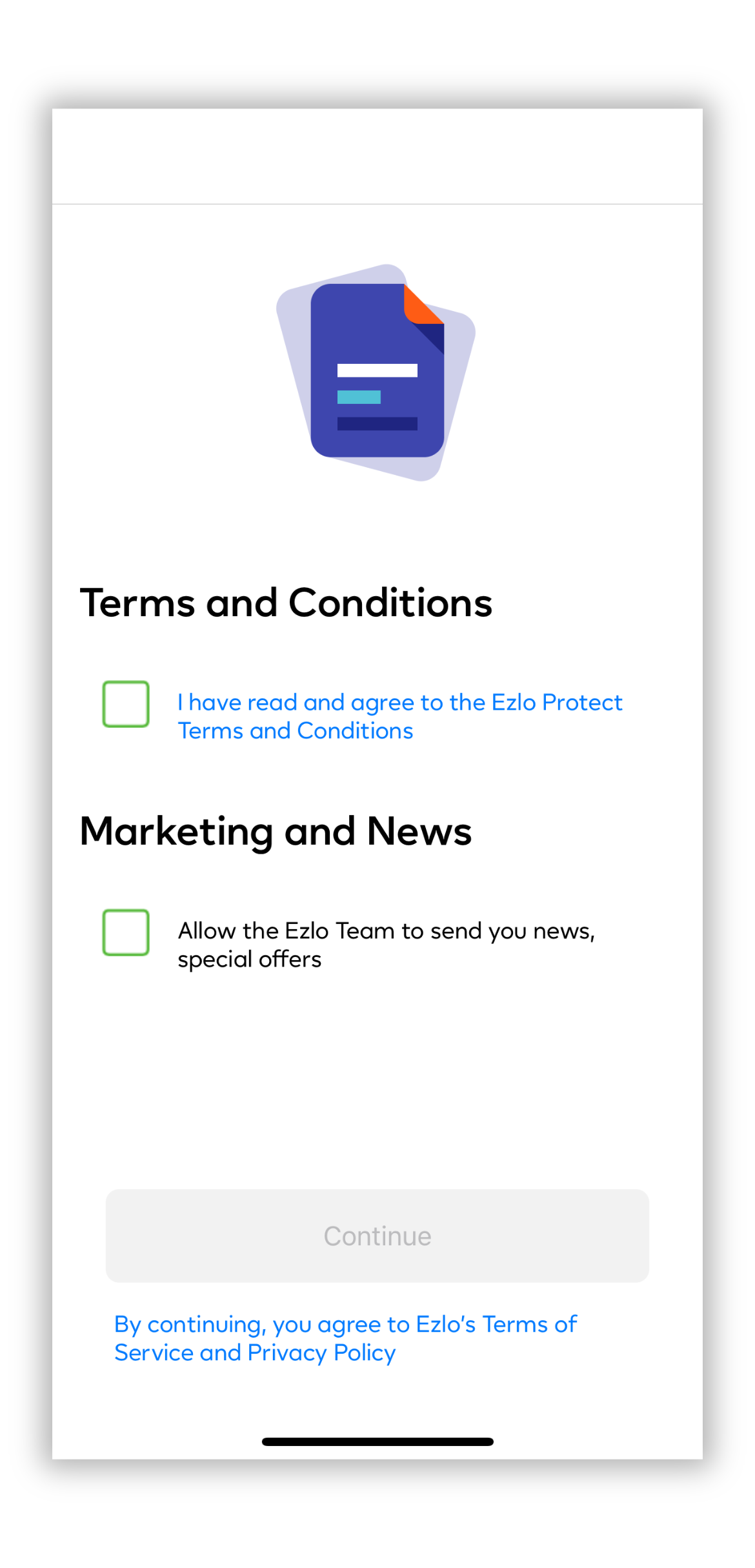

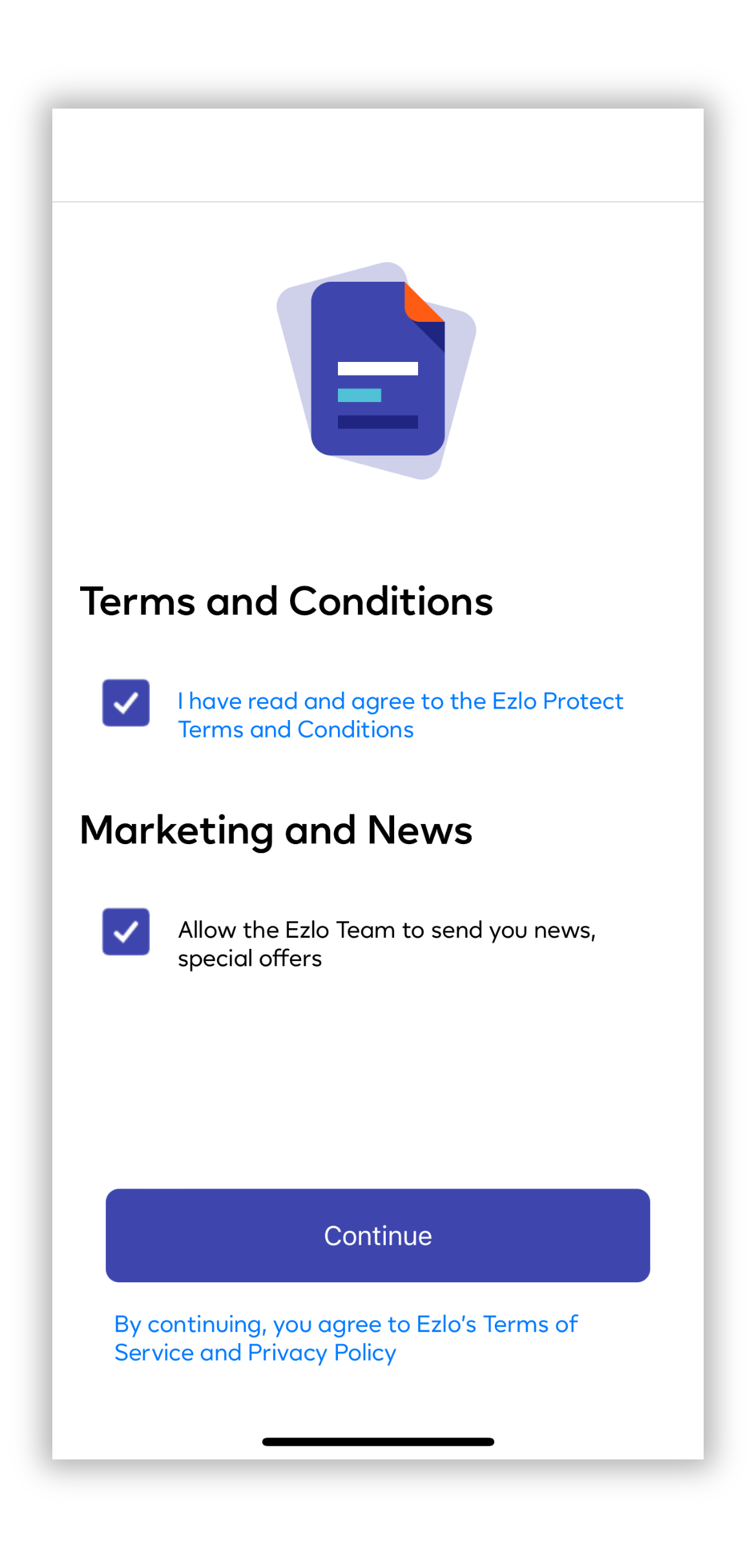

  • Accept the terms and conditions and tap on Continue

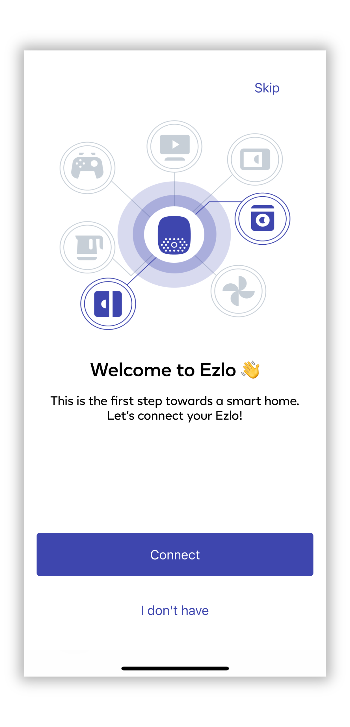

  • You will see the Welcome to Ezlo screen, tap on Connect to start adding the controller to your account
  • The app will display the list of controllers, please select the model of the controller you want to add to the MiOS app

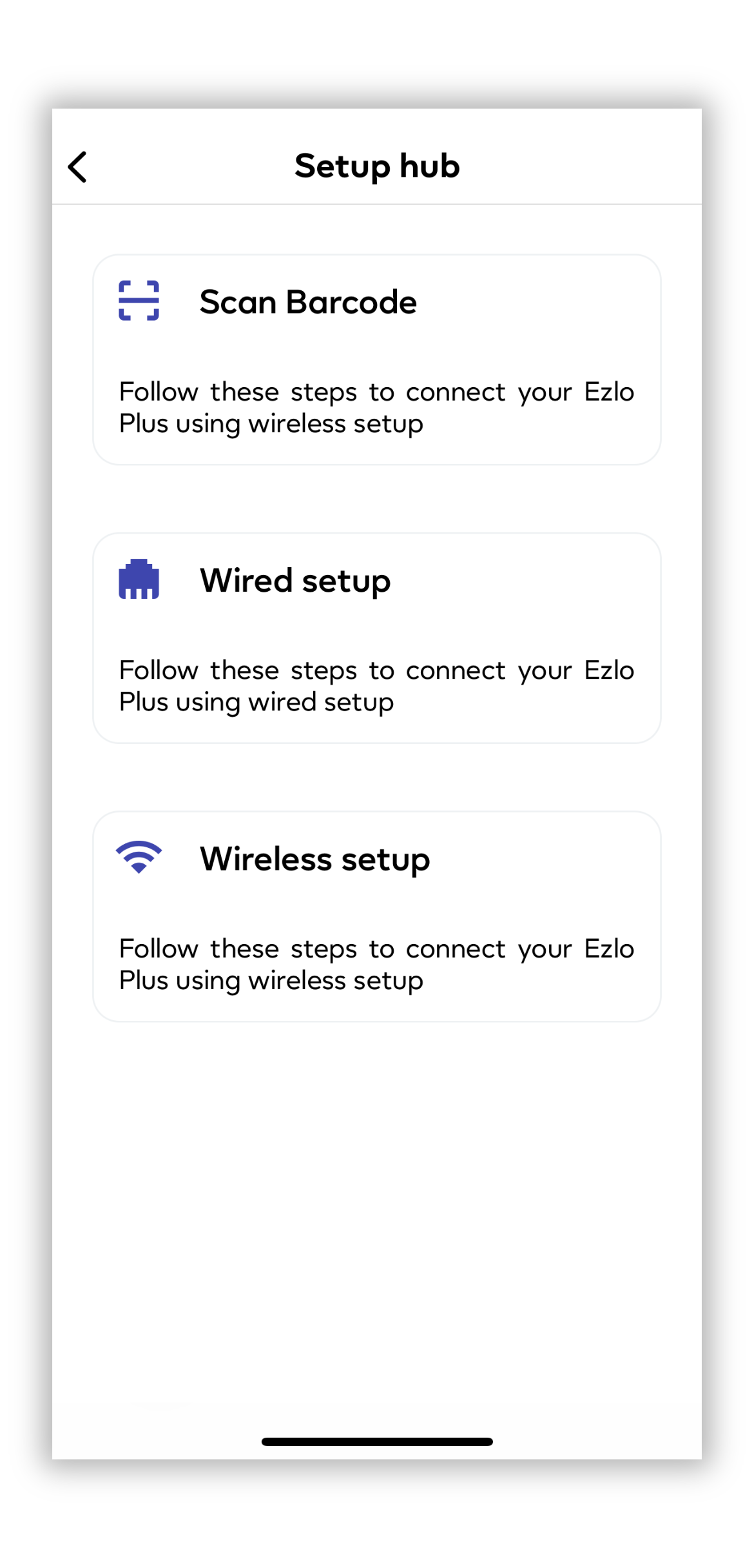

  • There are three ways to add the controller to the account:
    • Scan Barcode
    • Wired setup
    • Wireless setup
However, before continuing, the controller needs to be connected to the Internet network. To do that, you can either select
  • Wired setup
  • Wireless setup

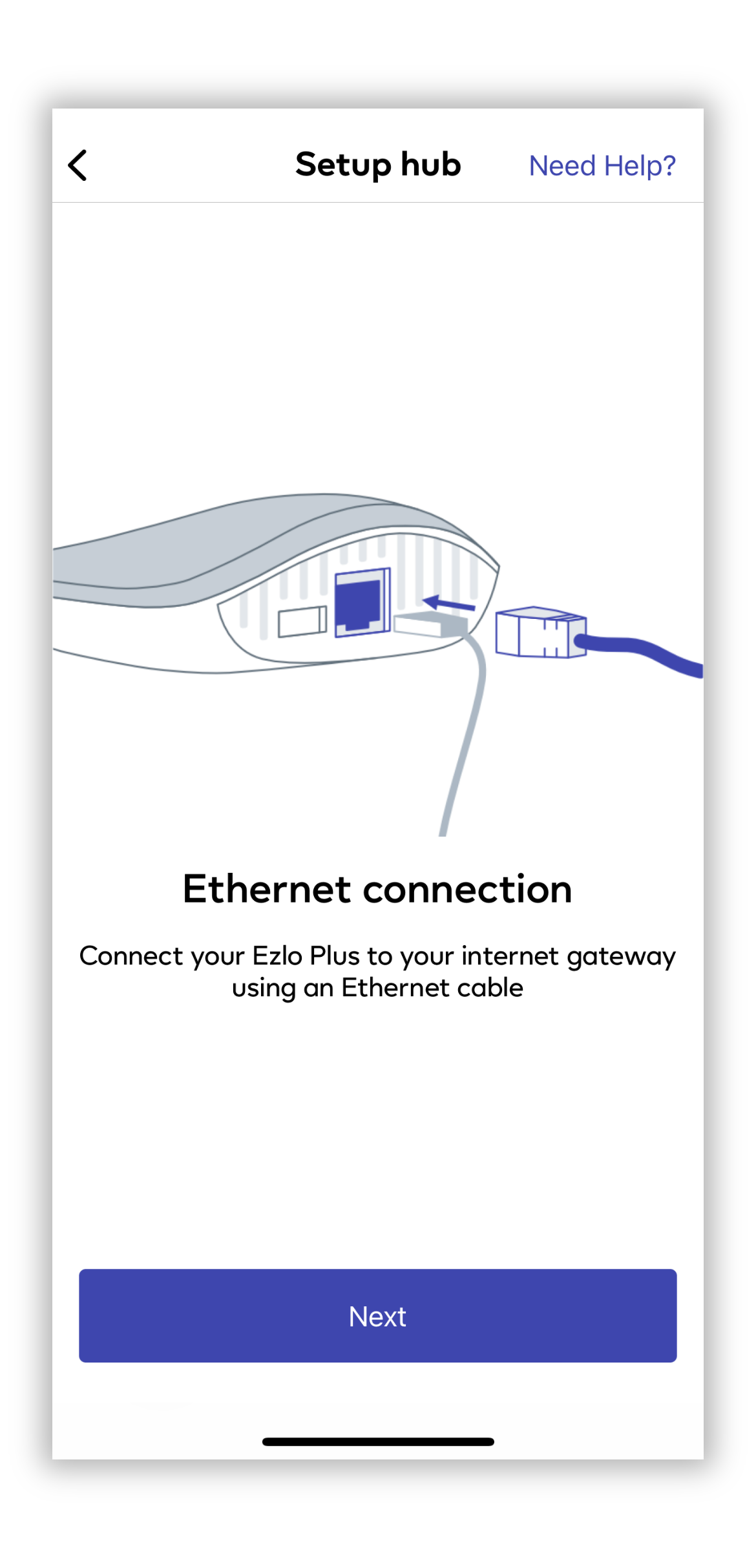

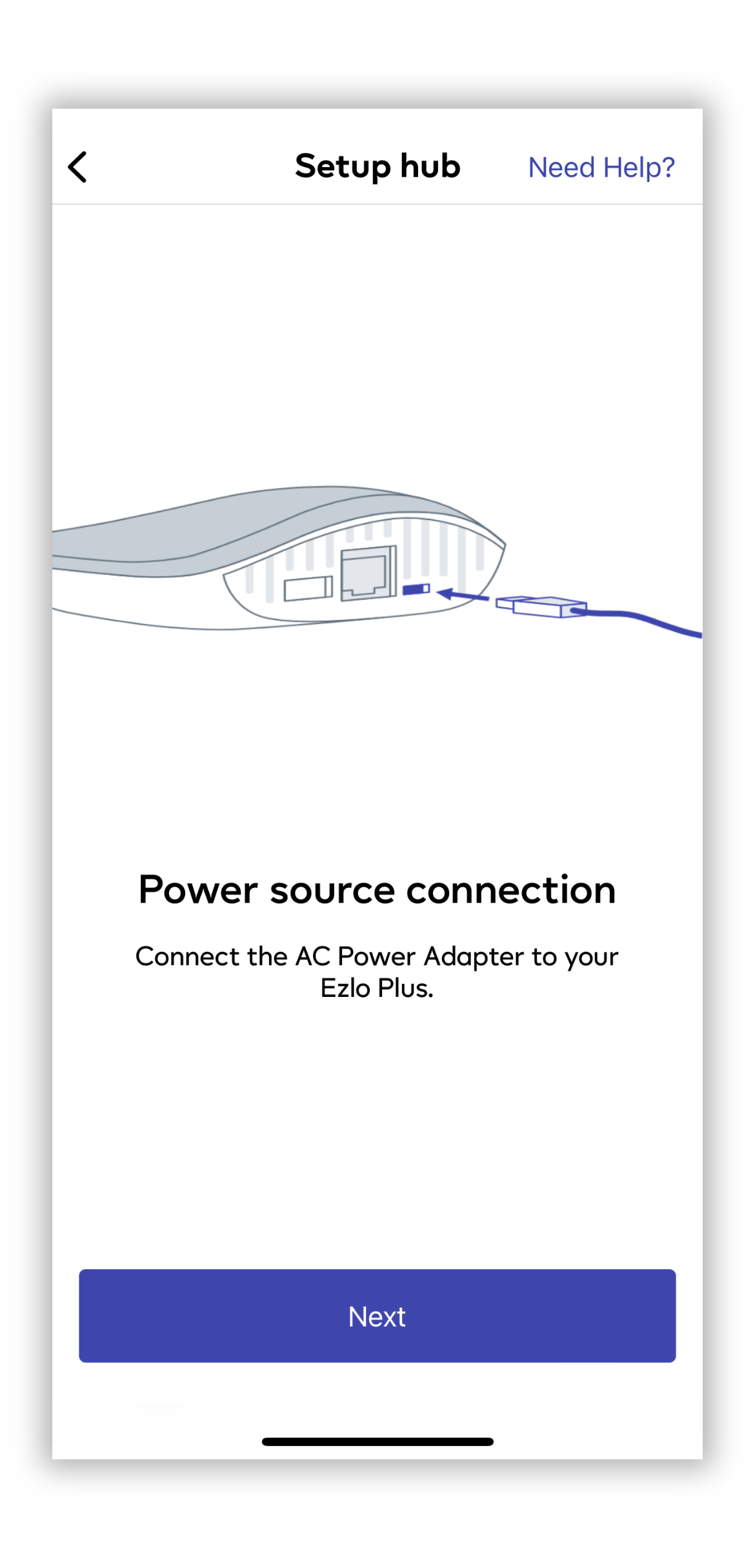

Connect the controller to the power outlet using the power adapter included in the box as shown on the app screen and tap on Next
Connect the controller to the router using the Ethernet cable on the box. To ensure that the controller can be found on the network, it must be connected to the main router/modem, then tap on Next
Once the controller has been found in the network, you will get a confirmation message

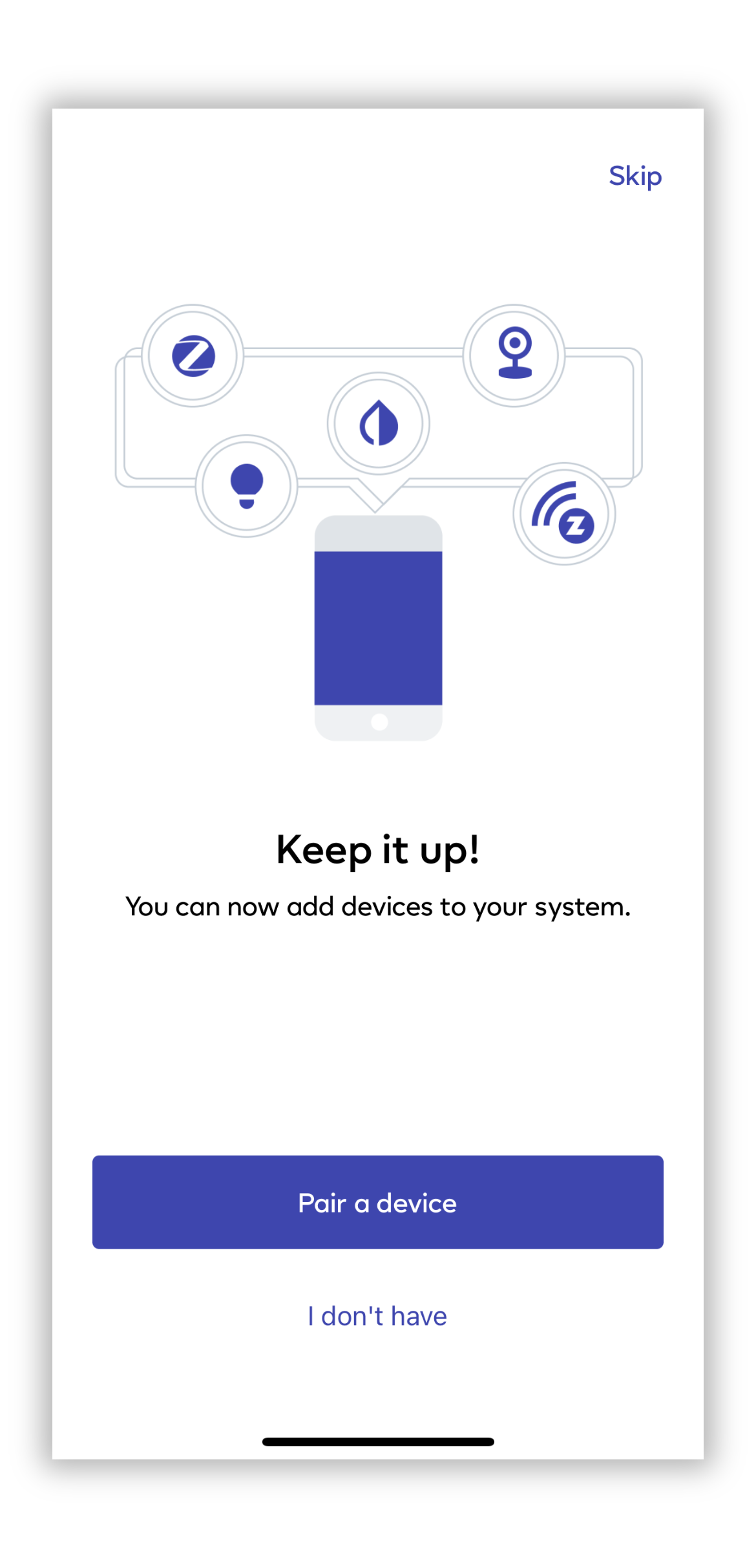

Tap on the Next button and you will be redirected to the main Dashboard of the app, which means you're ready to start using the MiOS app

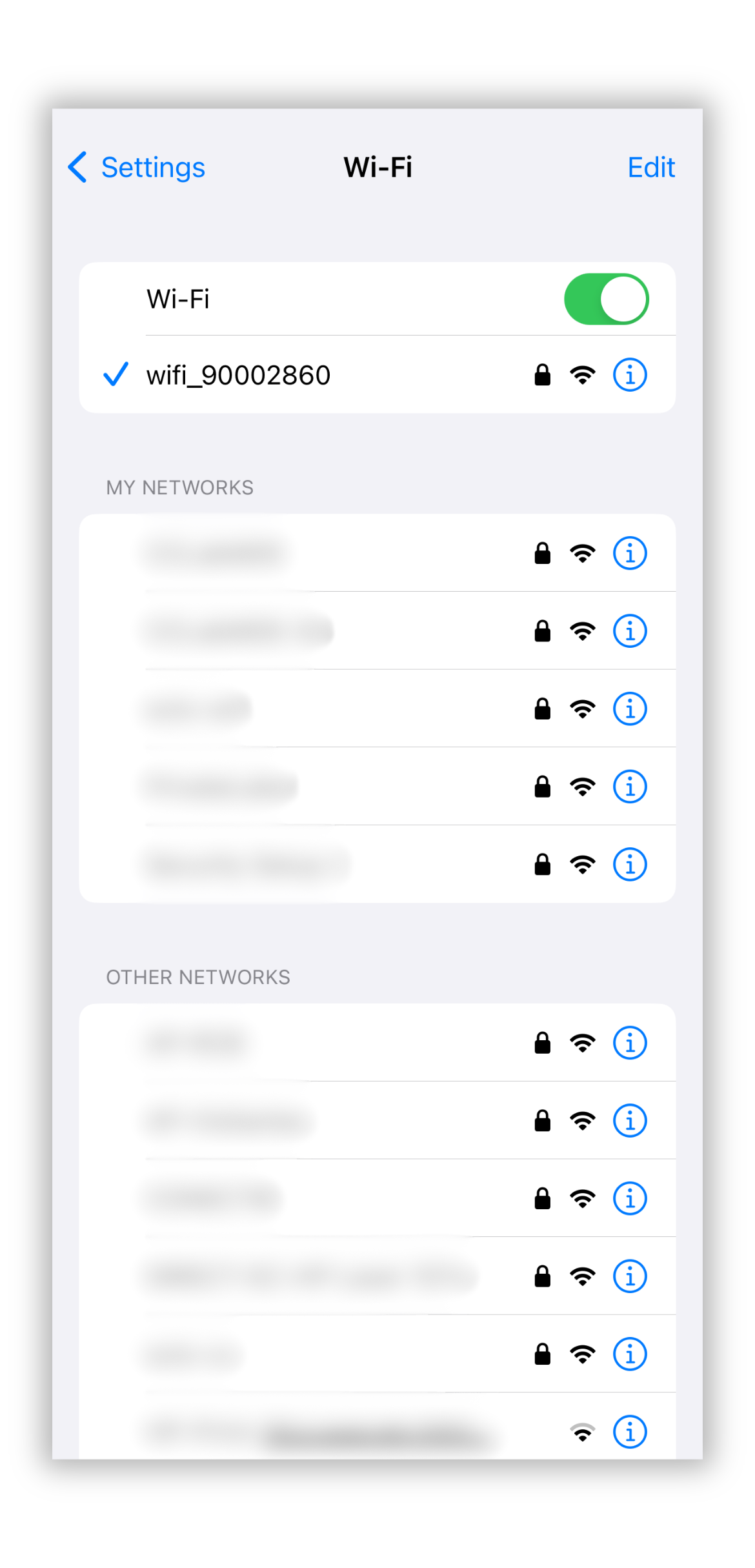

You will need to follow the on-screen instructions to connect the controller to your local WiFi Network:
  • Go to your phone's Settings menu, make sure to leave the MiOS app open in the background
  • Go to the WiFi Settings on your phone and search for the controller's WiFi network. You will see a network named wifi_SerialNumber (e.g wifi_9XXXXXXX)
  • Tap on that network and use the password located on the label at the bottom of the controller with the name WIFI
  • Once connected, return to the MiOS app to continue with the configuration

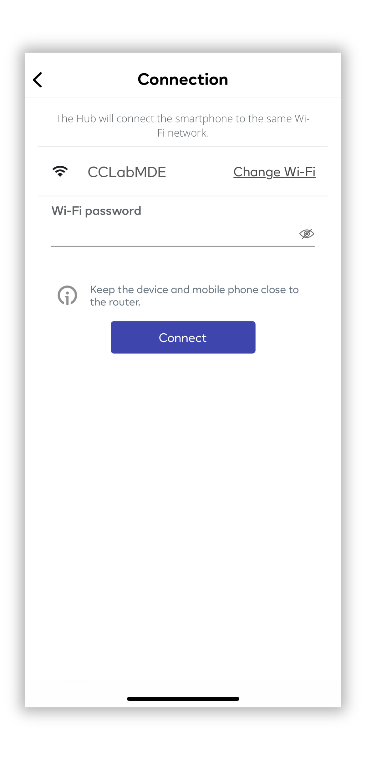

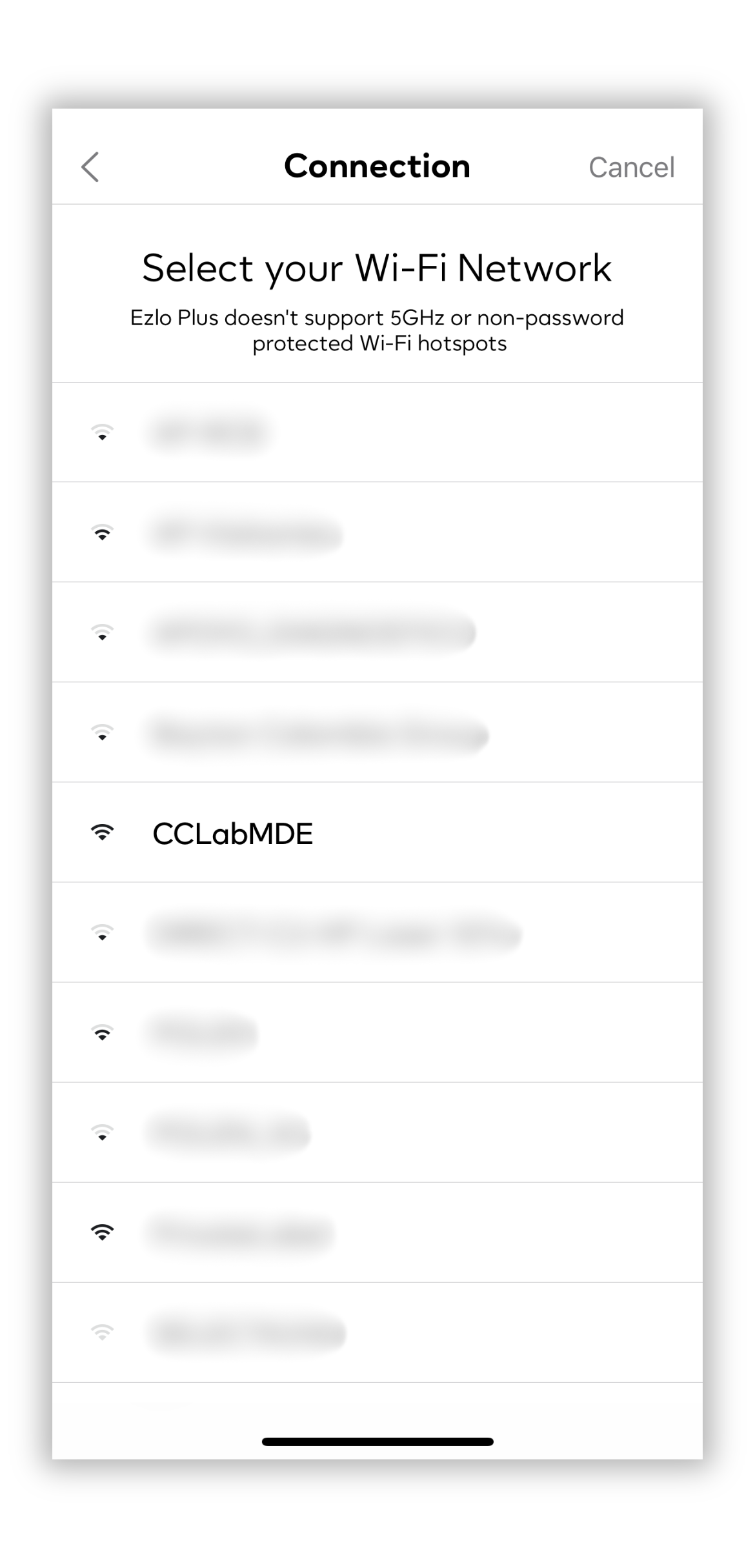

  • On the MiOS app, you will see the list of available networks in your location, select yours and enter the wifi password of your local network, then tap on Connect

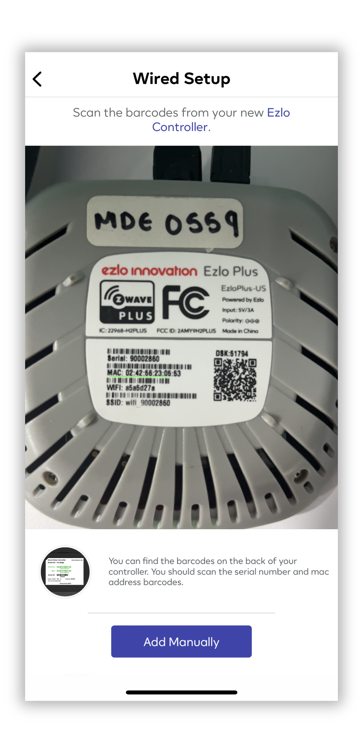

Scan Barcode
This option is intended to add the controller to the account, however, it will not connect the controller to the internet. You can use this option when the controller has been connected hardwired to the internet router
  • Tap on Scan Barcode
  • Allow the app access permission to the phone camera
  • Flip over the controller and you will find the label with the controller's information (serial number, MAC address, Wifi passkey, and SSID name) point the phone's camera to the Barcode on the controller, and make sure that you have centered the barcode on the phone's screen

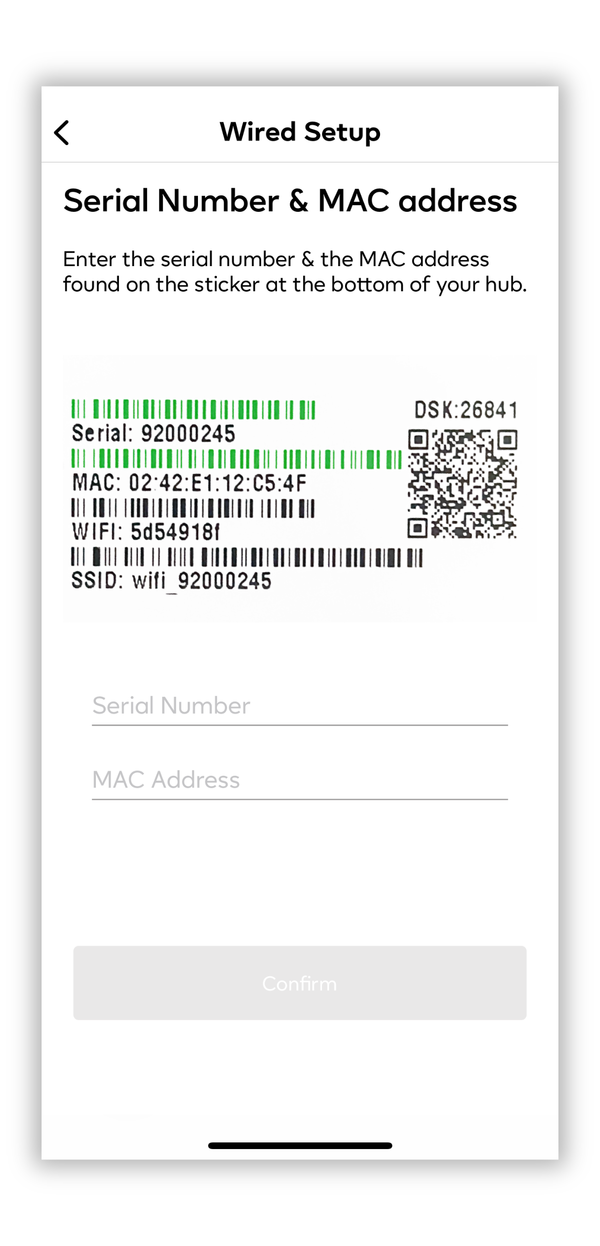

In case the phone's camera fails to read the Barcode or it's taking too long to read, you can tap on Add Manually and you will see this screen, where you can manually add the controller's Serial Number and MAC Address
Once the Barcode is successfully read or the information is added correctly, you will get a confirmation message, then tap on Next

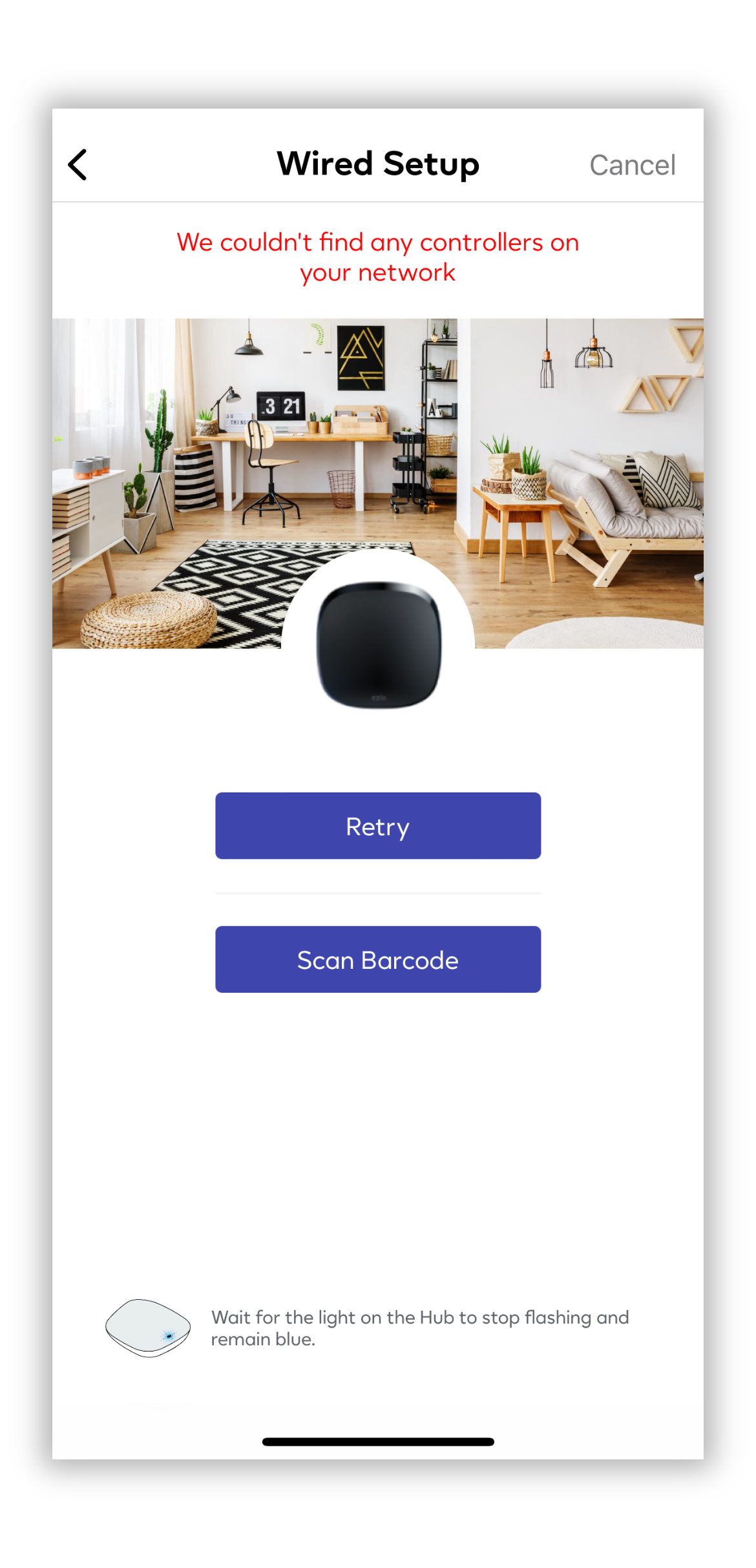

The Controller fails to be found in the wired network
This scenario could happen when the hardwire connection runs over a different subnet, the controller is connected to a switch, or an additional network device that differs from the Wifi settings, and thus the app fails to find the controller in the same network.
You will see this screen in the app when this happens
Tap on Scan Barcode and follow these instructions

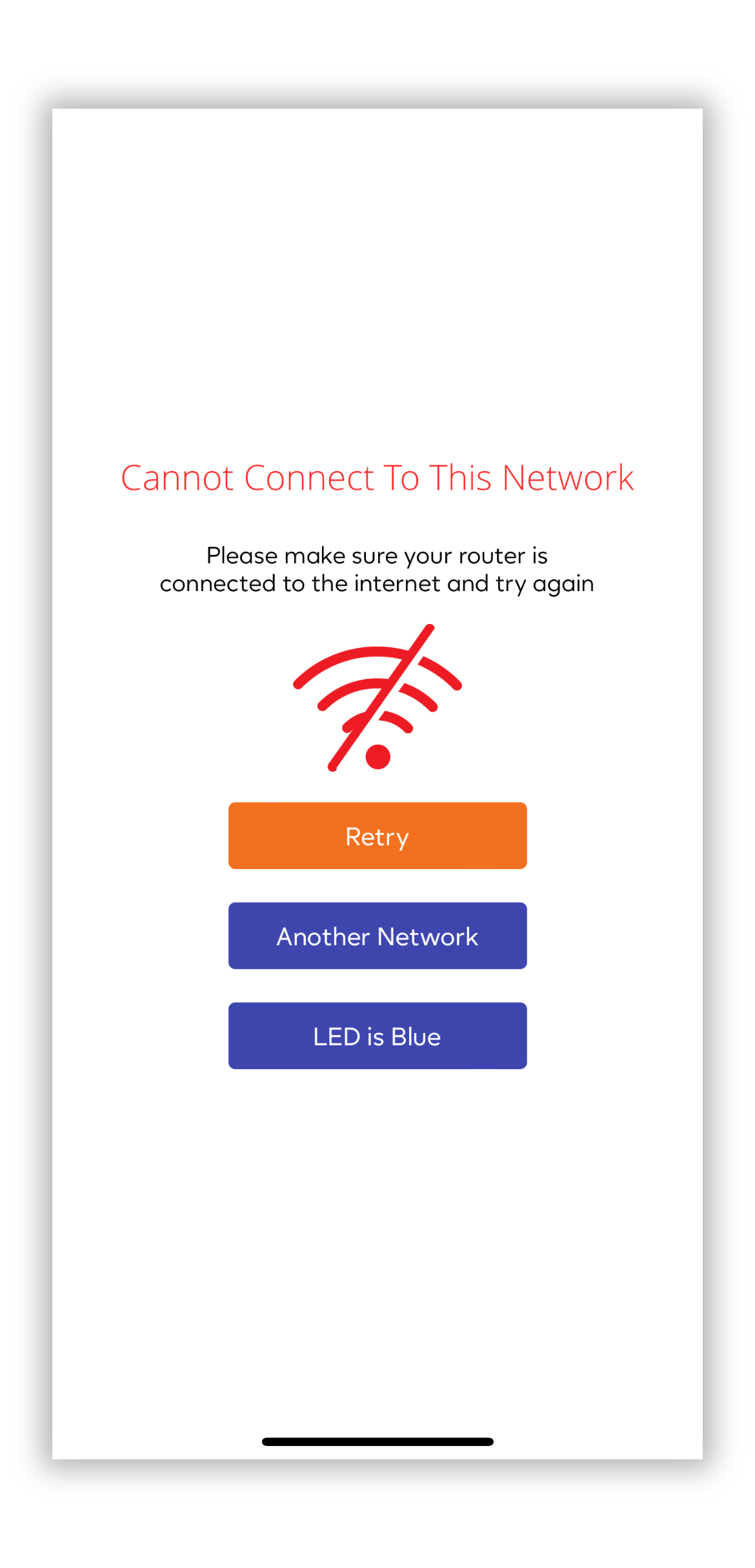

The controller cannot connect to the WiFi network
This could happen when the WiFi signal is not strong enough, or there may be a typo in the passkey/password of the network
In that case, you will see a message like this:
If you're entirely sure that the passkey/password is correct, you can tap Retry
If you have an additional network that you want to try, you can tap on Another Network and select another SSID
Now, if you notice that the LED on the controller changed from blinking Orange to solid Blue, you may tap on the LED is Blue button and you will be prompted to add the controller's Serial Number and MAC Address found in the back label of the unit
Finally, you will get a confirmation message and you can start using your controller with the MiOS app

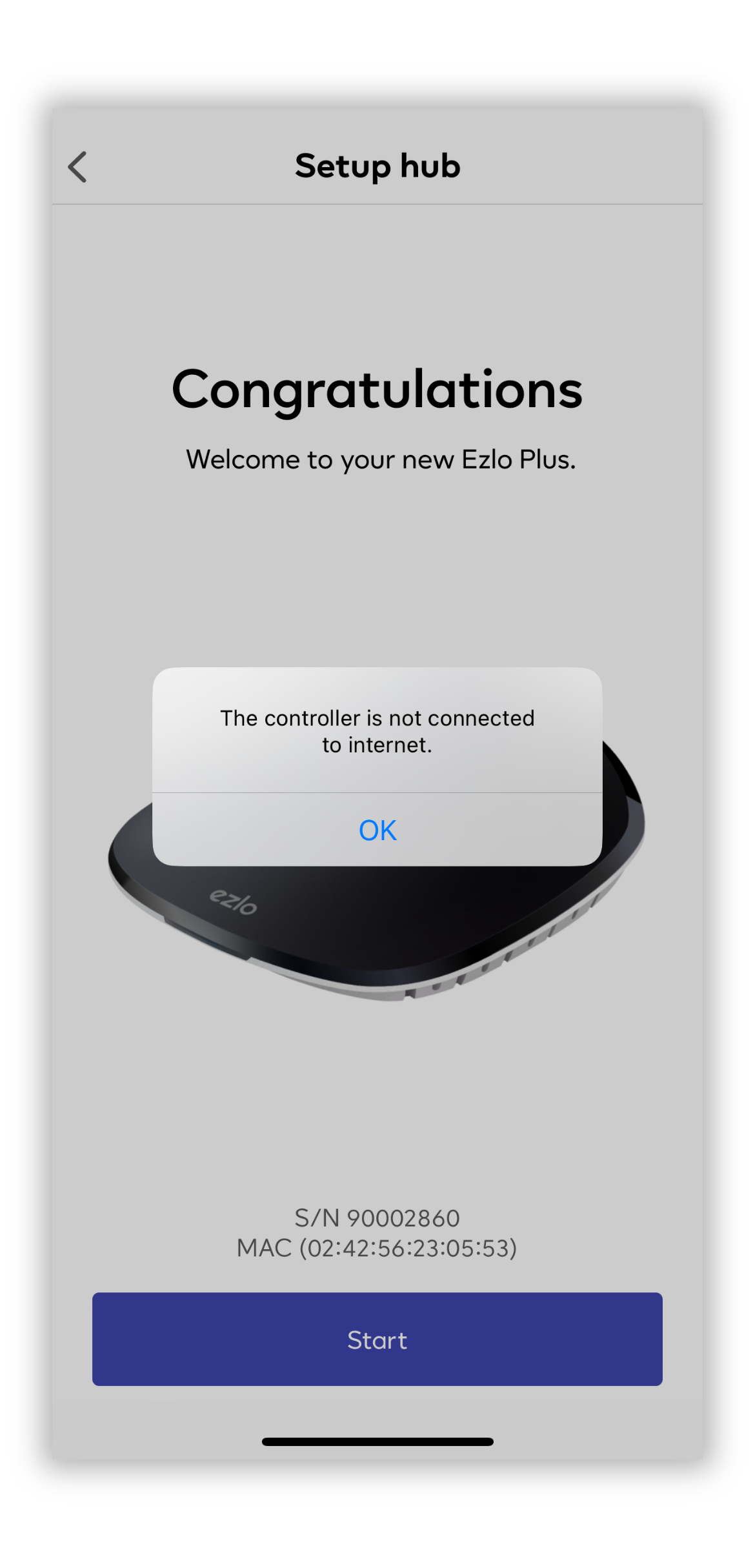

Controller Offline message when added via Scan Barcode
If you add the controller using this option and the app shows this error message
Double-check that the controller is connected through the Ethernet cable to the router, hard-close the app, and open it again, at this point, you should be able to see the controller online and you can start adding devices and creating Meshbots
