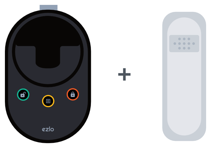

What's in the Box
What you’ll need
  • ¾”, 1” or 1¼” Ezlo Ball Valve (sold separately)
  • Home Wi-Fi Network
  • iOS or Android Smart Phone or Tablet

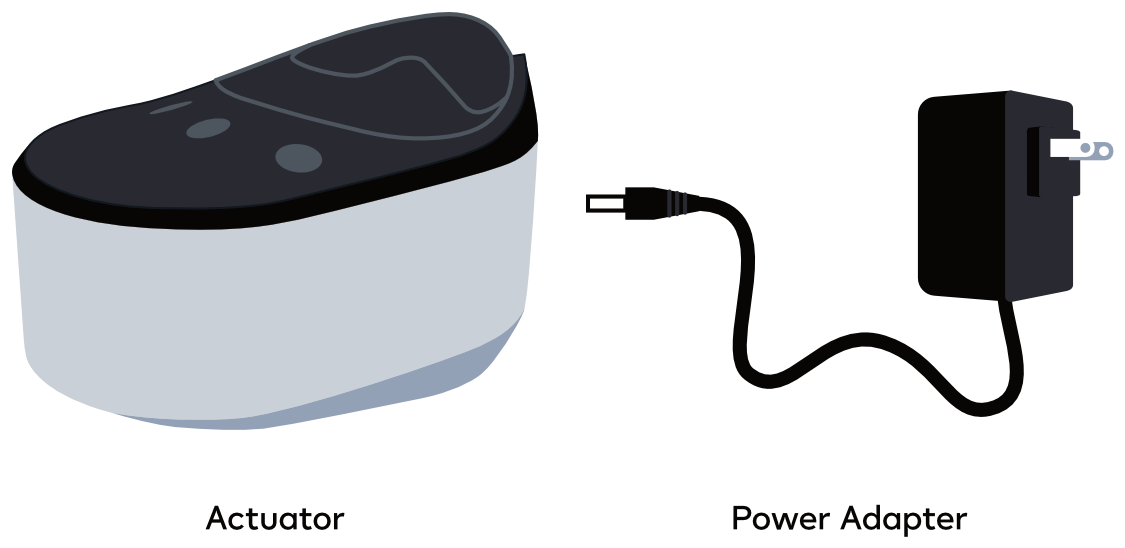

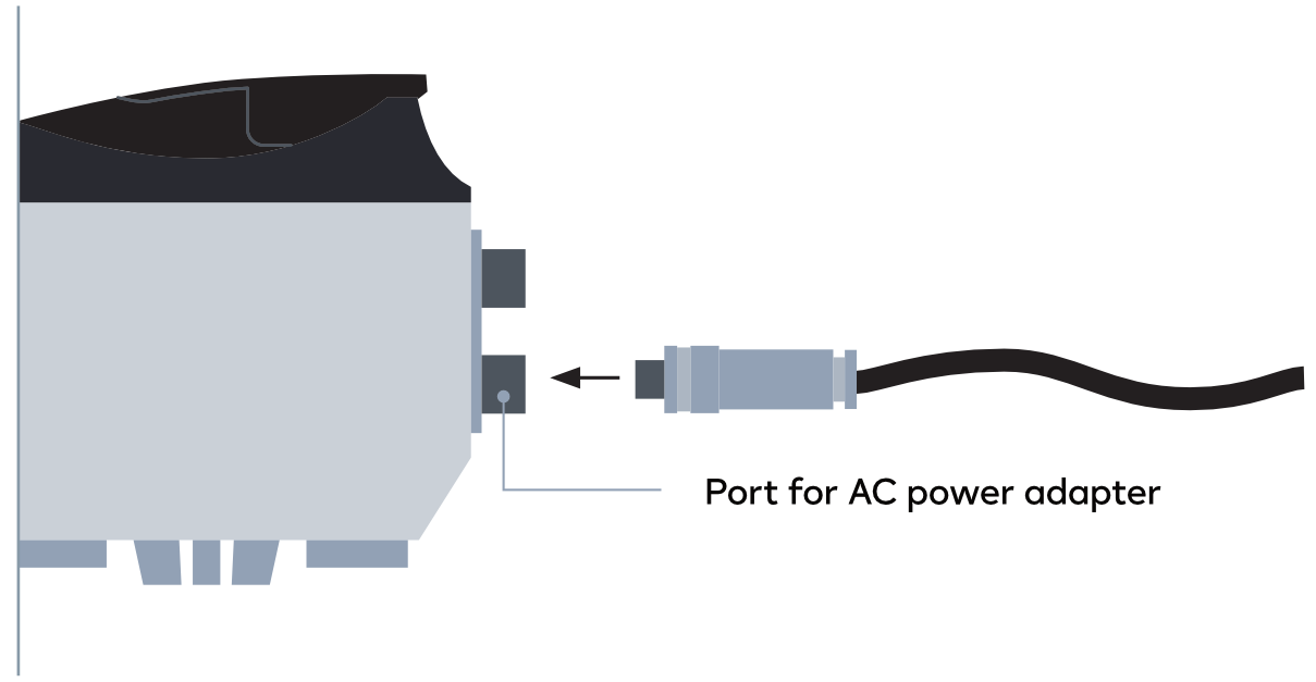

  3. Next, connect the A/C power adapter to the bottom port on the rear of your Smart Water Shut-Off Valve. Once it is powered on, the LED should blink orange

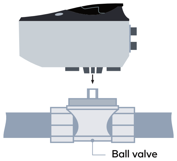

3. Connecting the Actuator to the Ball Valve
Once the ball valve has been plumbed into your home’s water system, disconnect the Smart Water Shut-Off Valve from its AC power cable and snap it into the ball valve. Then reconnect it to a nearby power source.
If your Smart Water Shut-Off Valve is outside or plumbed away from a power source, you may need to use an extension cord.

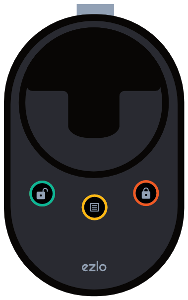

6. Reset button and LED ring behavior
6.png Network reset Two short pressings 3 blinks per second, stops when reset
process finishes then 1 per second
6.png Soft reset One long between 5 - 9.5 seconds 10 blinks per second, stops when reset process finishes. Starts blinking after 5th second of button pressed
6.png Factory reset One long, more than 10 seconds LED on, turn on when reset process finishes. Turn on after 10th second of button pressed
