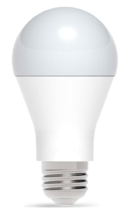

| Z-Wave Light Bulb | ||
1.1 Basic Information
CONTROL YOUR LIGHTS FROM ANYWHERE in the world from the palm of your hand. The bulb produces beautiful high quality light that you can dim, and control from your smartphone or tablet. Easy to setup, the bulb fits into a standard household socket - no need for installation by an electrician.
SAVE ENERGY: LED bulbs use up to 84% less energy than traditional incandescent bulbs and last up to 25,000 hours making them a smart choice for energy conscious homes.
