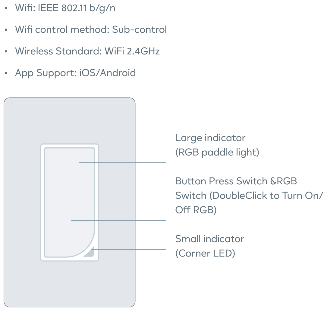

1. Product Introduction
1.1 Indicator description
The Switch has two indicators.

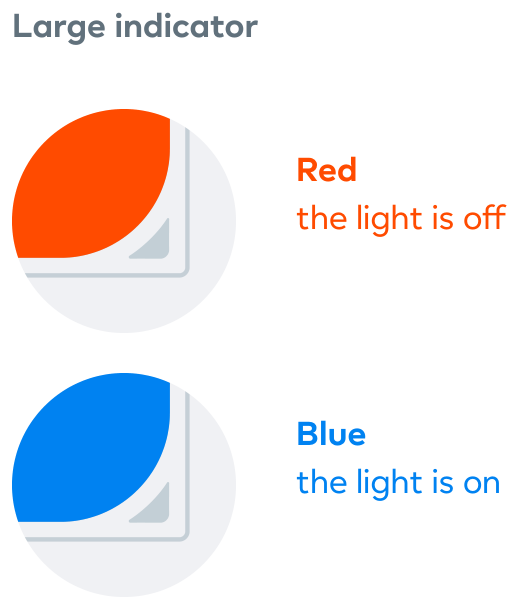

Large indicator, the RGB paddle light. Shows whether the light the Switch controls is on or off.
• Blue: the light is on
• Red: the light is off
Small indicator, the corner LED. Shows what the Switch is doing on Bluetooth and Wi-Fi. See 1.2.

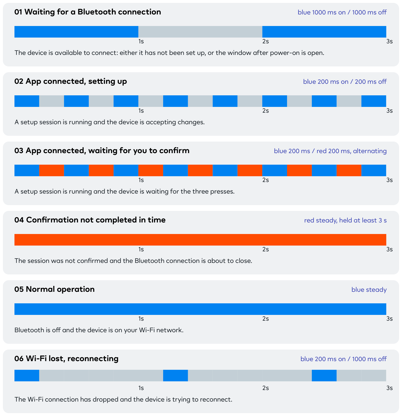

1.2 Setup and connection indicator
These six patterns show what the device is doing while you connect it, and afterwards. Each strip below covers three seconds.
Reading the indicator
WHAT YOU SEE WHAT IT MEANS WHAT TO DO
Blue, blinking once a second Waiting for a Bluetooth connection. Normal right after power-on, and on a device that has not been set up yet. Connect from the MiOS App.
Blue, blinking fast The app is connected and setting the device up. Nothing.
Blue mixed with red The app is connected and needs you to confirm you are at the device. Press the main paddle three times within 10 seconds.
Red, steady The confirmation was not completed in time, so the setup session was refused. Connect again and repeat the three presses.
Blue, steady Normal operation. The device is on your Wi-Fi network. Nothing.
Blue, a brief flash once a second Wi-Fi has dropped and the device is reconnecting. Check your router and the signal strength where the device is installed.

1.4 Button functions
• Press and release the main paddle to turn the switch on or off.
• Double-click the main paddle to turn the RGB light on or off.

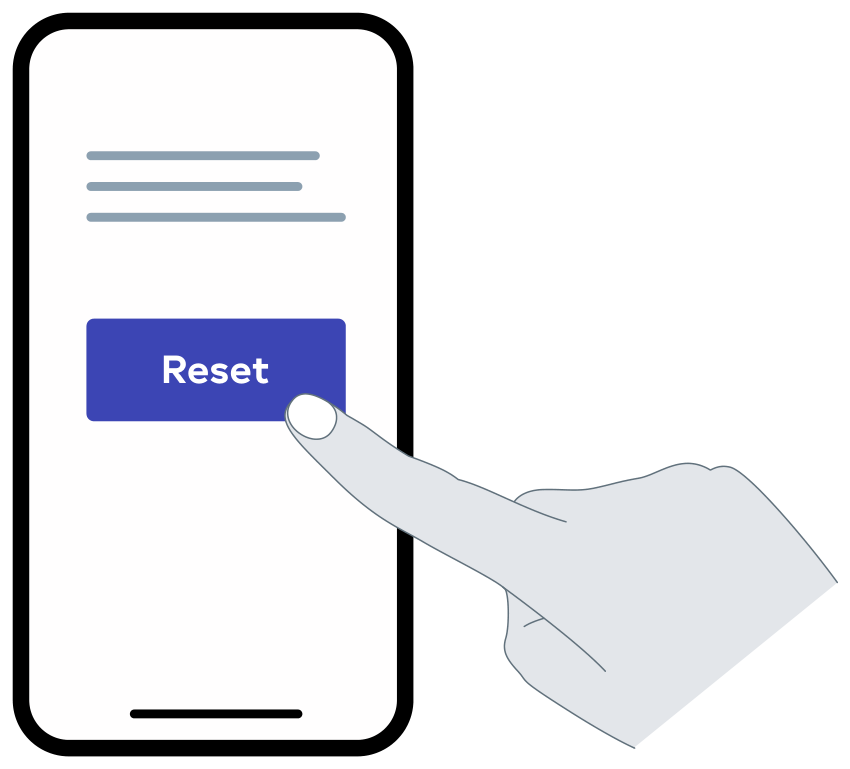

1.5 Restoring factory state
Use the MiOS App to factory reset the device. You can also remove the device from the devices list in the MiOS App. See the Troubleshooting section below.

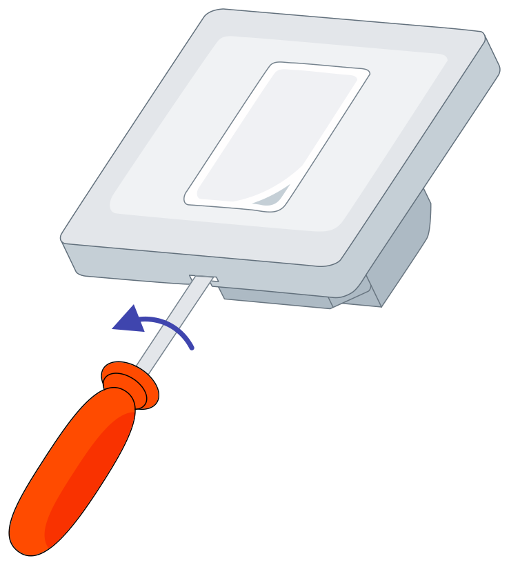

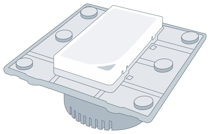

2.2 Removing the faceplate
Insert a flathead screwdriver in the recessed hole on the bottom of the plate and turn the screwdriver counterclockwise.

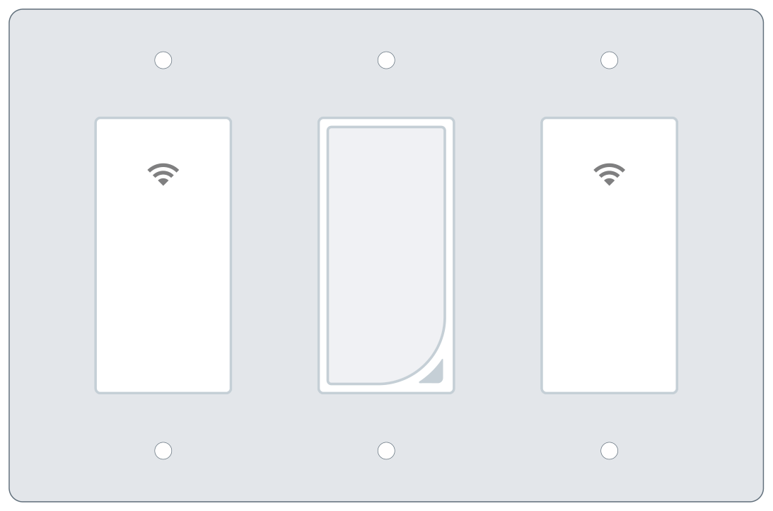

2.3 Combined 2-gang and 3-gang switches
• The side angle of the sheet metal can be disassembled.
• 2-gang or 3-gang switches can be seamlessly connected, which fully conforms to the size of the home switch box.

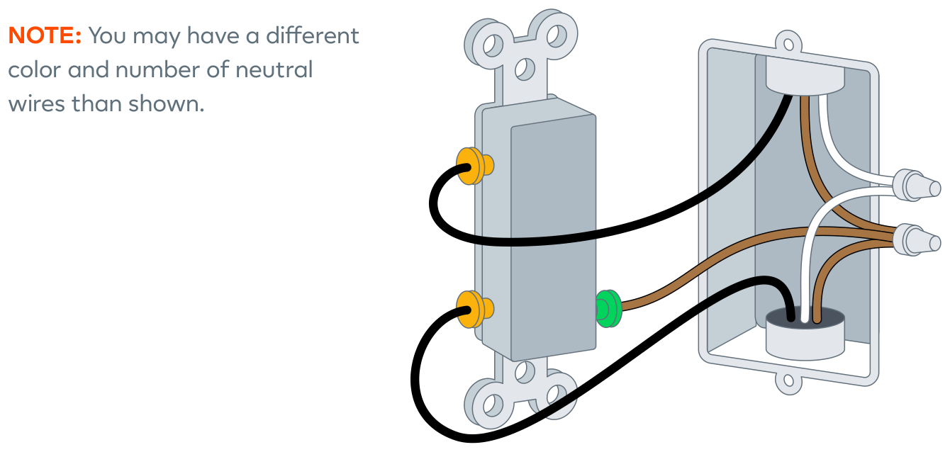

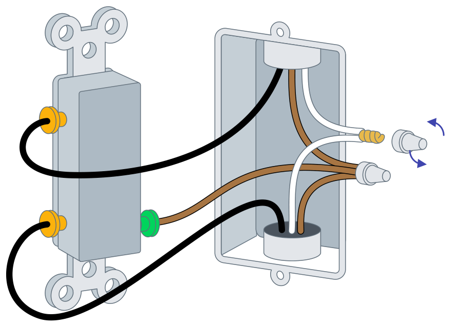

Step 2: Find the neutral wires
Remove the cover plate from the existing switch. Use a voltage tester to test BOTH sides of the switch. You may need to turn OFF more than one circuit breaker or fuse.
Unscrew the existing switch and gently pull it out of the wall. Look for the neutral wires, usually white. You need these to install the device. Continue ONLY if you have the neutral wires.
Note: you may have a different colour and number of neutral wires than shown.
Use a voltage tester to check that there is no power in the neutral wires from neighbouring circuits. If necessary, shut OFF additional circuits until no voltage is found. Then unscrew the wire nut connecting the neutral wires.
Step 3: Find the ground wires
Look for the ground wires, usually green or solid copper, and unscrew the wire nut connecting them.
Note: your existing wires may be in different locations than shown. Never label wires while the power is turned on.

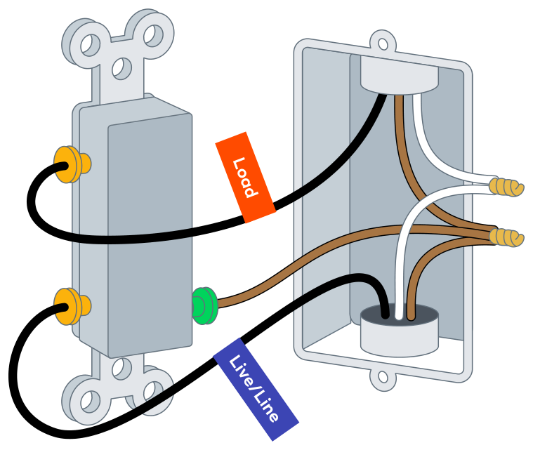

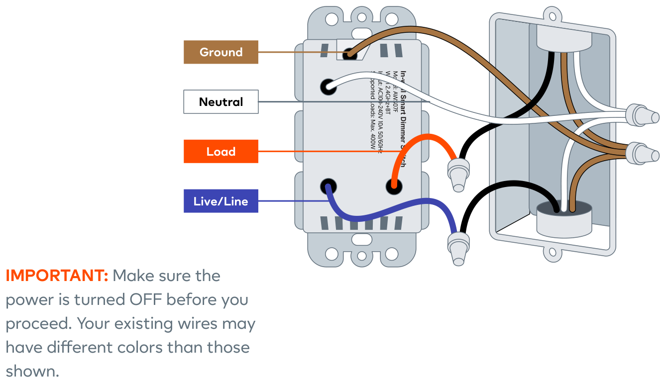

Step 4: Find and label the line and load wires
Step 5: Connect the wires
IMPORTANT: make sure the power is turned OFF before you proceed. Your existing wires may have different colours than those shown.

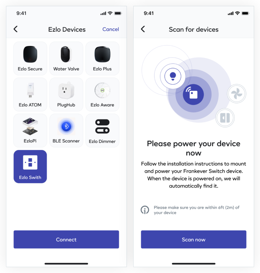

4. Adopt the Frankever Switch to the MiOS App as an EzloPi device
1. Power on the Frankever Switch.
2. Make sure your mobile device is within 6 ft (2 m).

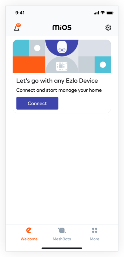

3. Open the MiOS App and tap “Connect”.
4. Choose “Ezlo Switch” from the list, then “Scan now”.
5. Wait for the app to detect the Frankever Switch.
6. Select the detected device from the list.

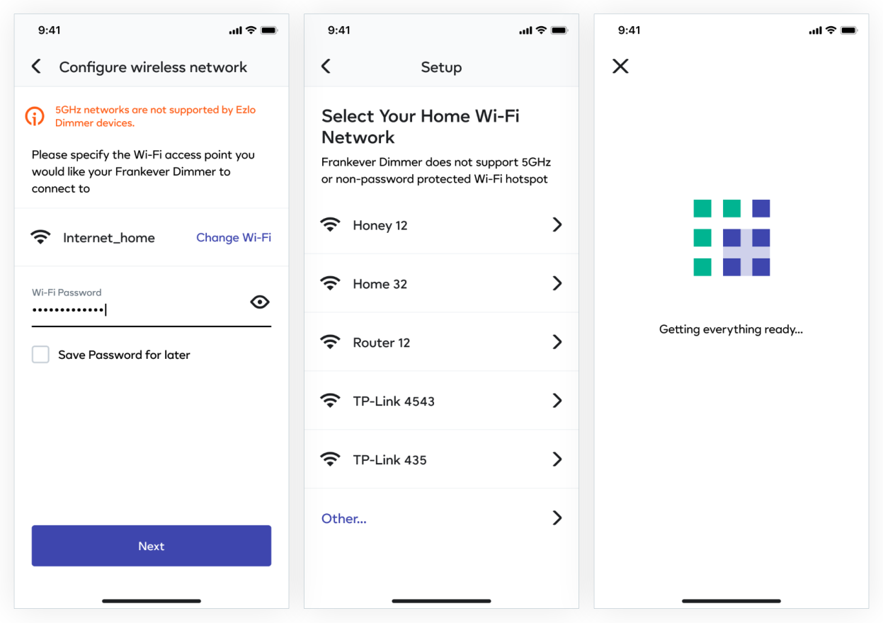

7. Choose your Wi-Fi network. 2.4 GHz only, there is no 5 GHz support.
• Enter the Wi-Fi password if prompted.
• You may also have the option to save the password for future connections.
8. If the indicator shows blue mixed with red, the app is asking you to confirm you are at the device. Press the main paddle three times within 10 seconds.

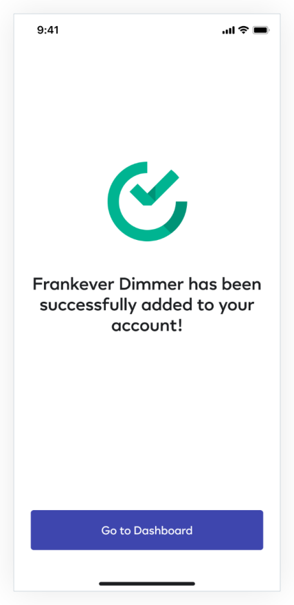

9. Confirm the connection and wait for the setup to complete. The device then installs a software update, see 1.3.
10. If successful, the Frankever Switch is added to your MiOS account.

Step 1: Reset and remove in the app. If the device has been added to your account, open the MiOS App, factory reset the device, then remove it from your device list.
