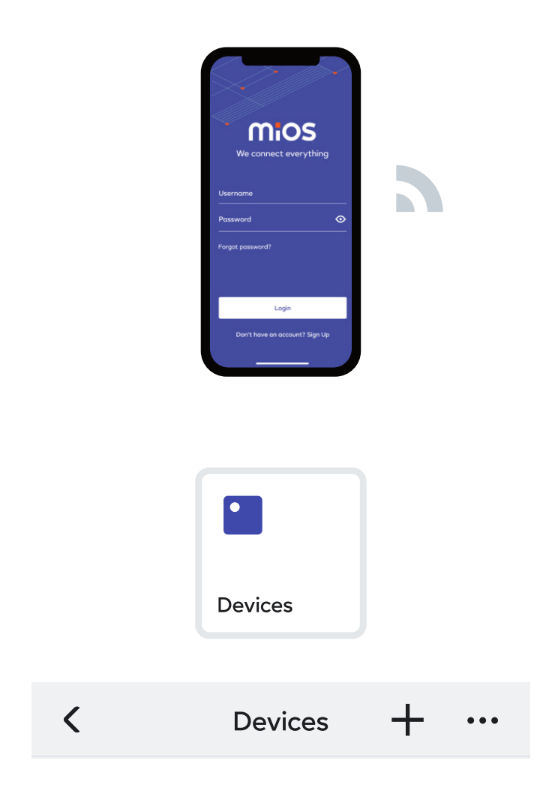

• Ensure your mobile device has Wi-Fi enabled and is connected to your local network.
• Open the MiOS app and log in if you haven’t already.
Step 2: Add a New Device
• Tap on “More” then navigate to the “Devices” section in the app.
• Tap on the “+” icon to add a new device.
• Select your “active hub” from the list of Controllers.

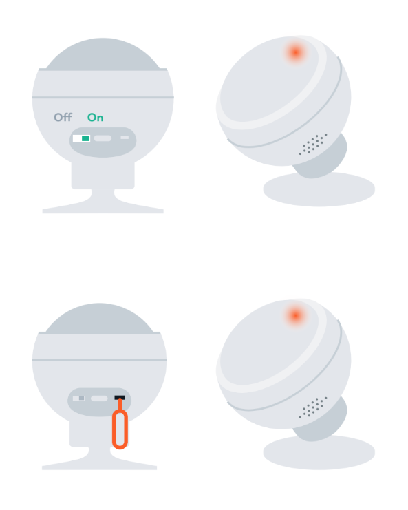

Step 4: Prepare the sensor

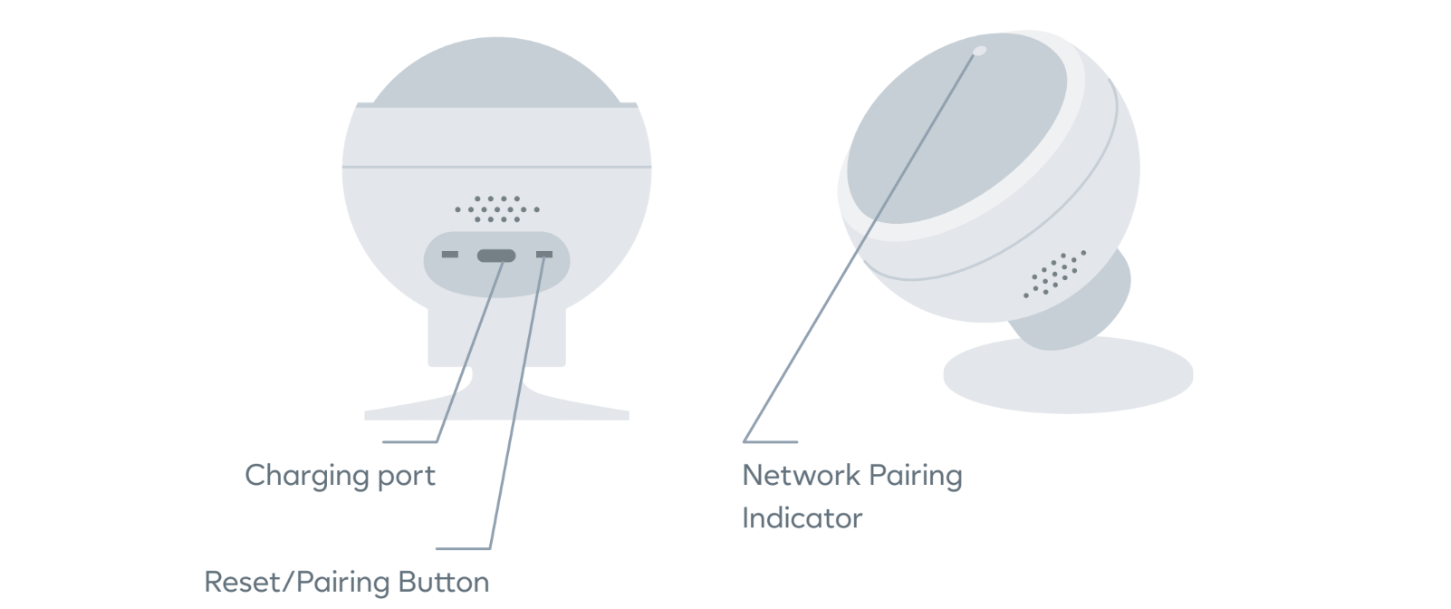

• To power on the sensor, toggle the switch on the left side to the 'On' position. A red LED will turn on, indicating the device is powered.
Step 5: Pair the sensor
• Use the included pin to press and hold the sensor's reset button for five seconds to pair it with your controller. The LED will blink red, indicating the sensor is in pairing mode.
