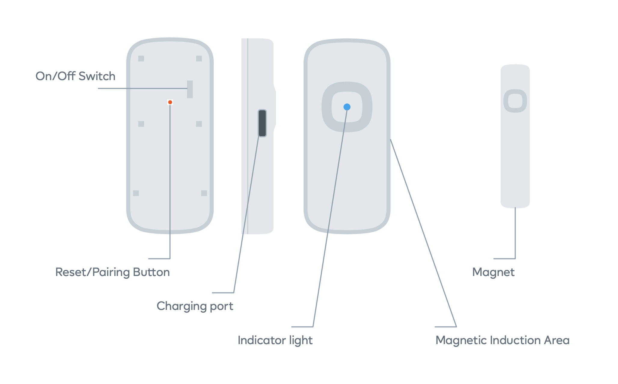

The Centralite Indoor Entry Sensor detects the opening and closing of the doors and windows and works in conjunction with other devices and smart home hubs which enables smart home automation and app alerts. Ensure the door magnet is located on the side of the alignment mark.

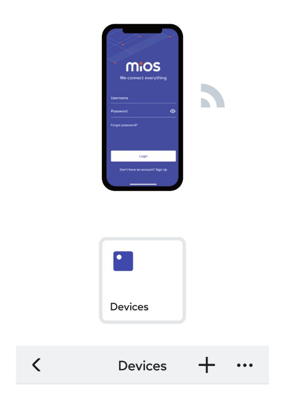

• Ensure your mobile device has Wi-Fi enabled and is connected to your local network.
• Open the MiOS app and log in if you haven’t already.
Step 2: Add a New Device
• Tap on “More” then navigate to the “Devices” section in the app.
• Tap on the “+” icon to add a new device.
• Select your “active hub” from the list of Controllers.

• Slide the bracket down from the back of the sensor to reveal the On/Off switch and Reset button. Toggle the switch to the On position to power the sensor.
Step 5: Pair the sensor
• Press and hold the sensor's reset button for five seconds to pair it with your controller. The LED will blink red rapidly, indicating the sensor is in pairing mode.
