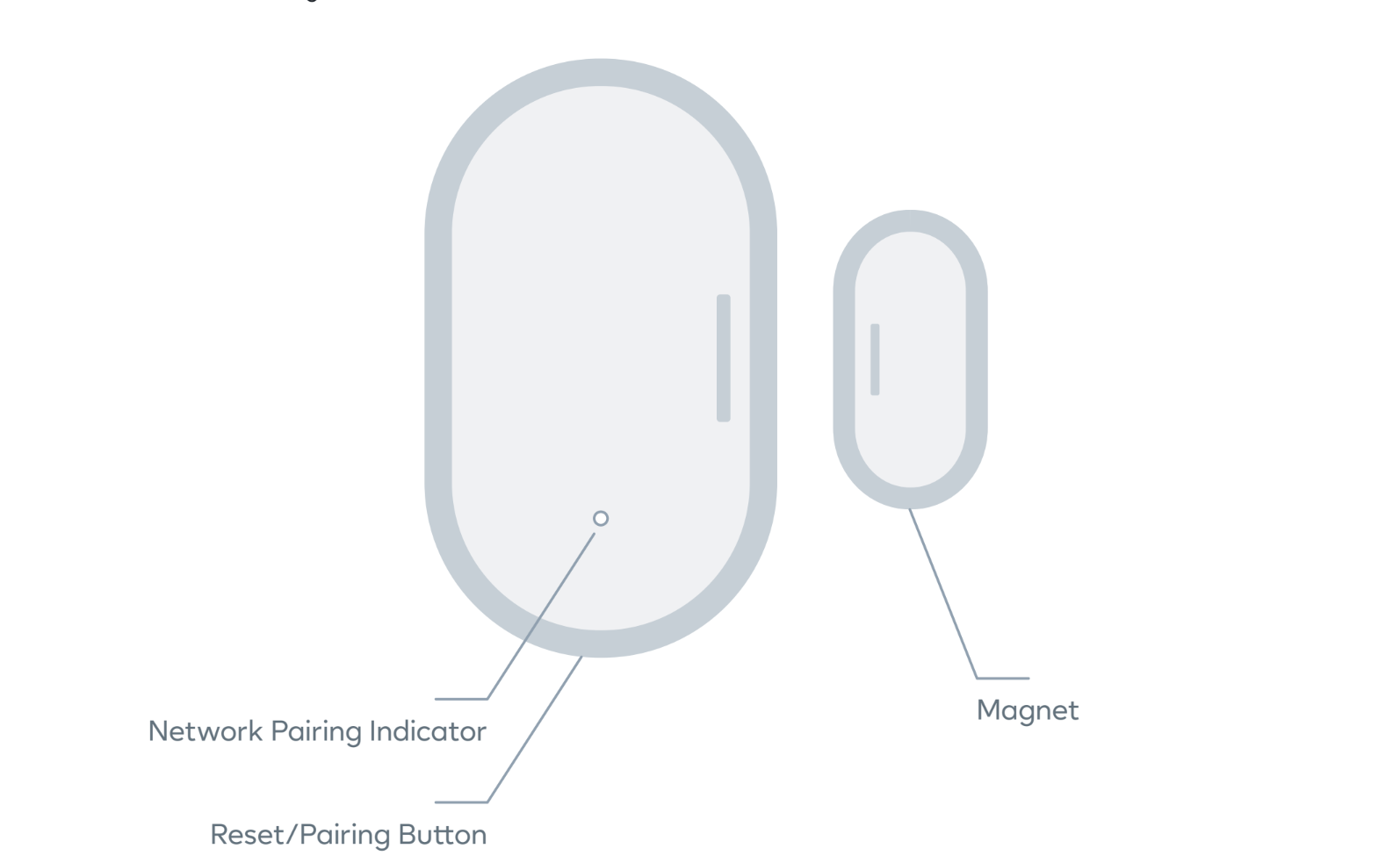

The Centralite Indoor Entry Sensor detects the opening and closing of the doors and windows and works in conjunction with other devices and smart home hubs which enables smart home automation and app alerts. Ensure the door magnet is located on the side of the alignment mark.

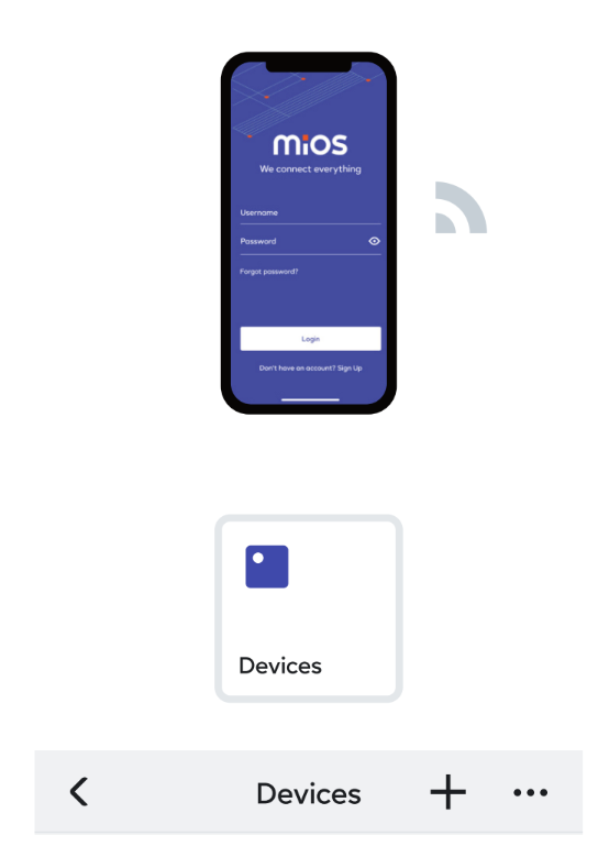

• Ensure your mobile device has Wi-Fi enabled and is connected to your local network.
• Open the MiOS app and log in if you haven’t already.
Step 2: Add a New Device
• Tap on “More” then navigate to the “Devices” section in the app.
• Tap on the “+” icon to add a new device.

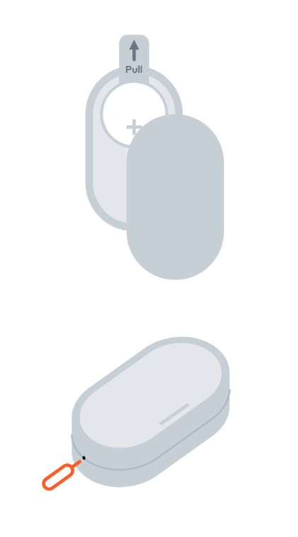

• Remove the back cover, then pull the battery tab to power on the sensor.
Step 5: Pair the sensor
• Use the included pin to press and hold the sensor's reset button for five seconds to pair it with your controller. The LED will blink blue rapidly, indicating the sensor is in pairing mode.

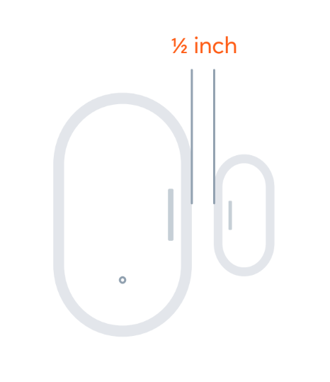

• Align the contact magnet with the sensor and stick the contact magnet onto the door panel or window frame at no more than ½ inch away from the sensor.
