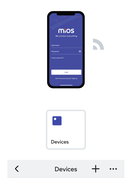

• Ensure your mobile device has Wi-Fi enabled and is connected to your local network.
• Open the MiOS app and log in if you haven’t already.
Step 2: Add a New Device
• Tap on “More” then navigate to the “Devices” section in the app.
• Tap on the “+” icon to add a new device.
• Select your “active hub” from the list of Controllers.

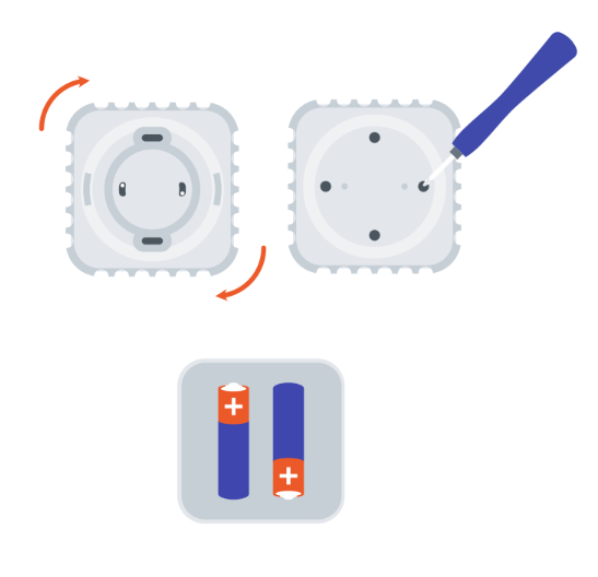

• Twist the bottom bracket clockwise to remove it, then use a small Phillips screwdriver to remove the four screws.
• Carefully insert the two AAA batteries with the correct polarity, then reassemble the bottom case.

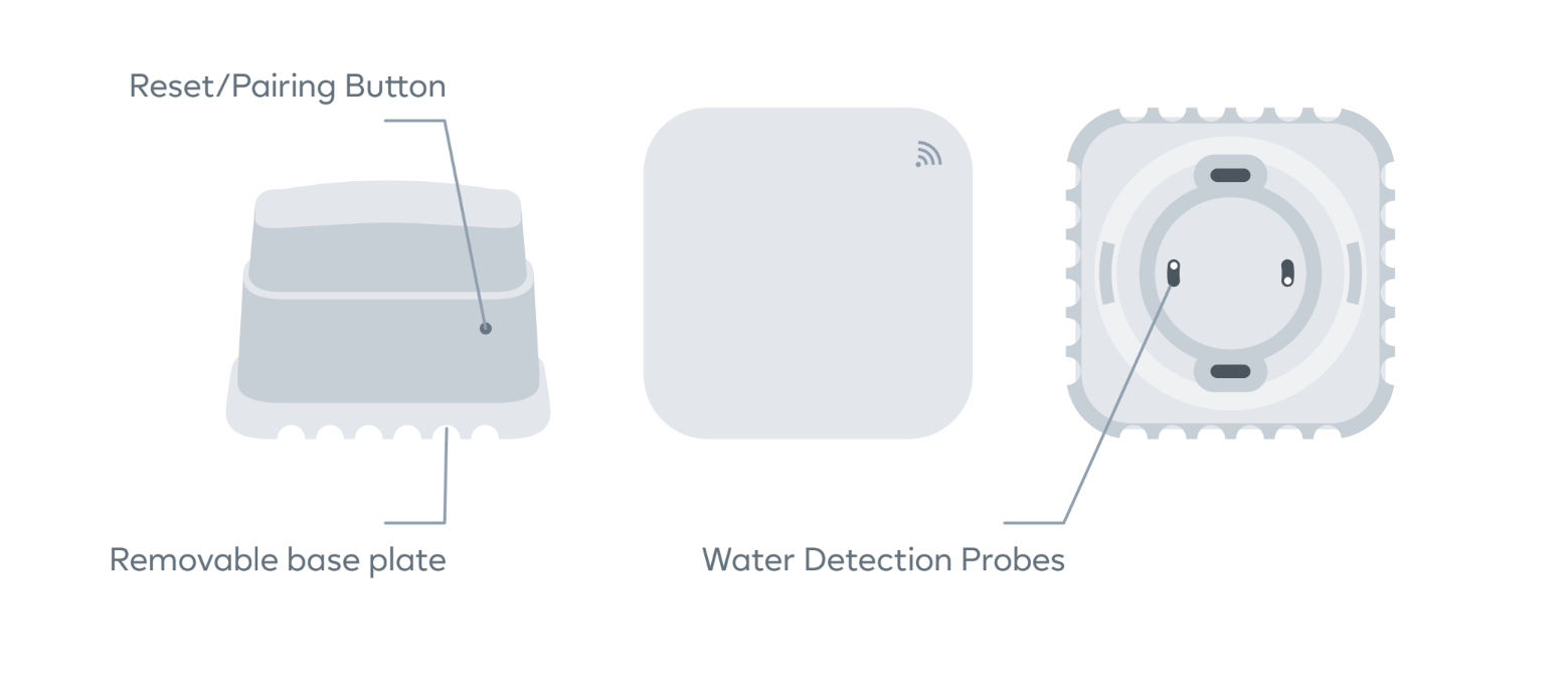

• Use the included pin to press and hold the sensor's reset button for five seconds to pair it with your controller.
