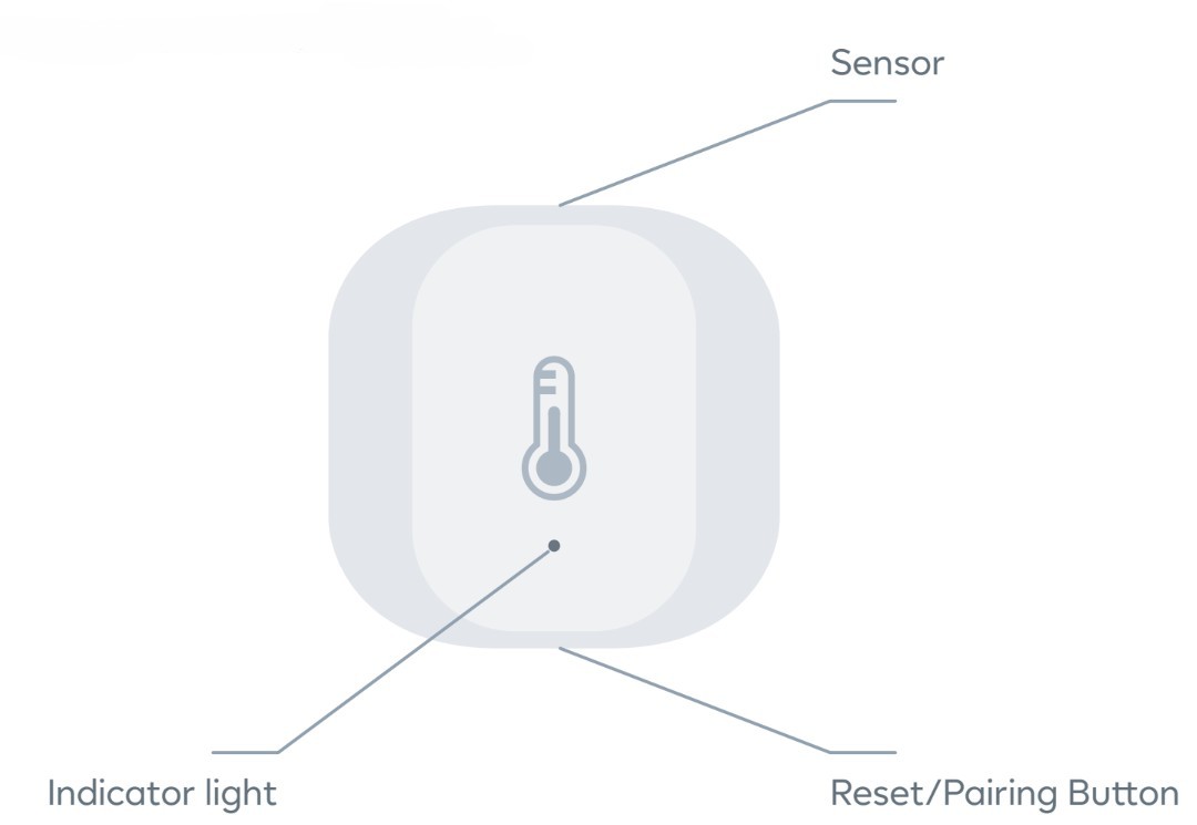

Model Number CLZ-3374-C
Battery Specifications CR2032 (included)
Temperature accuracy +/- 0.1°F
Humidity accuracy +/- 3%
Operating temperature 14°F – 120°F
Operating humidity 0% – 90% RH (no condensation)
Wireless Connectivity ZigBee 3.0

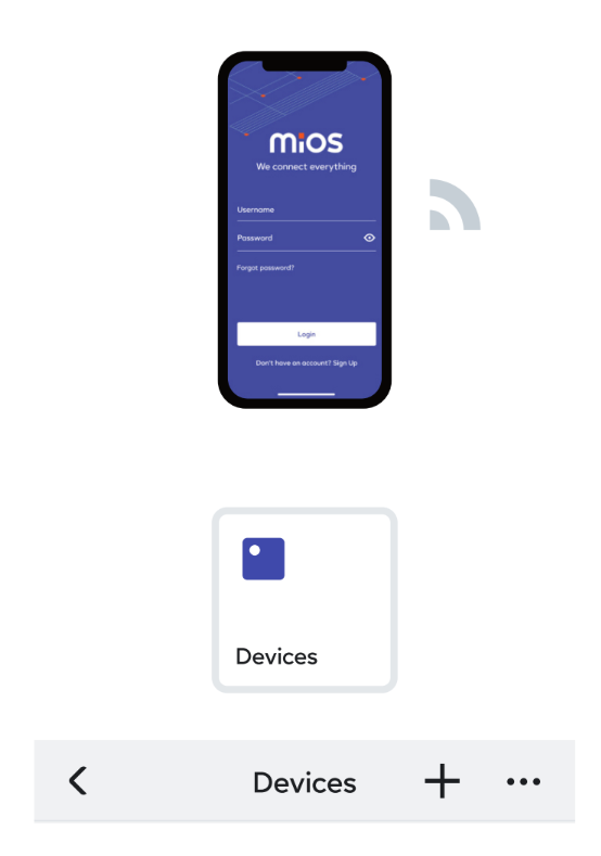

• Ensure your mobile device has Wi-Fi enabled and is connected to your local network.
• Open the MiOS app and log in if you haven’t already.
Step 2: Add a New Device
• Tap on “More” then navigate to the “Devices” section in the app.
• Tap on the “+” icon to add a new device.
• Select your “active hub” from the list of Controllers.

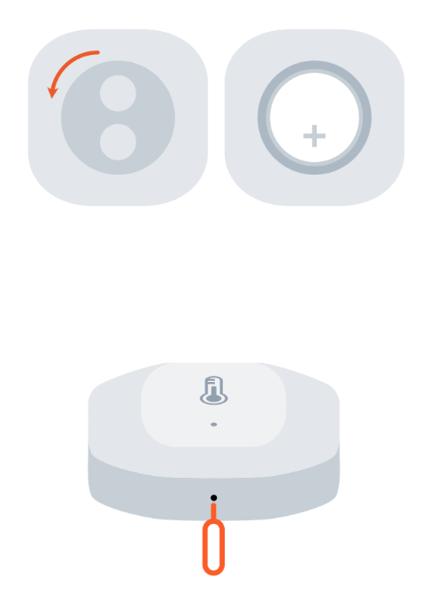

Step 4: Prepare the sensor
• Twist the back cover counterclockwise to remove it, then insert the CR2032 battery to power on the sensor.
Step 5: Pair the sensor
• Use the included pin to press and hold the sensor's reset button for five seconds to pair it with your controller. The LED will blink blue rapidly to indicate the sensor is in pairing mode.
Optional: If the sensor isn't detected in the next 60 seconds, click the ‘Retry’ button and begin the reset process.
