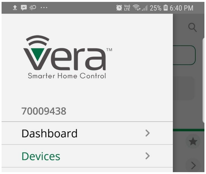

Open the mobile app, and tap on the three-line icon in the top right corner to open the
left-hand-side menu, then select Devices

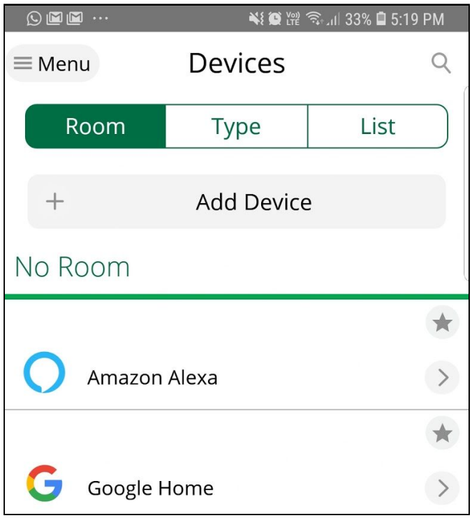

On the device screen, tap on Add Device

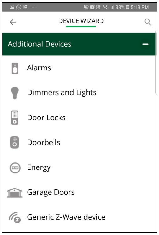

Look for the device you want to pair, and once you find it select it from the list. If your device is in the
list, you will get a dedicated Device Pairing wizard, which will walk you through the procedure
step by step.

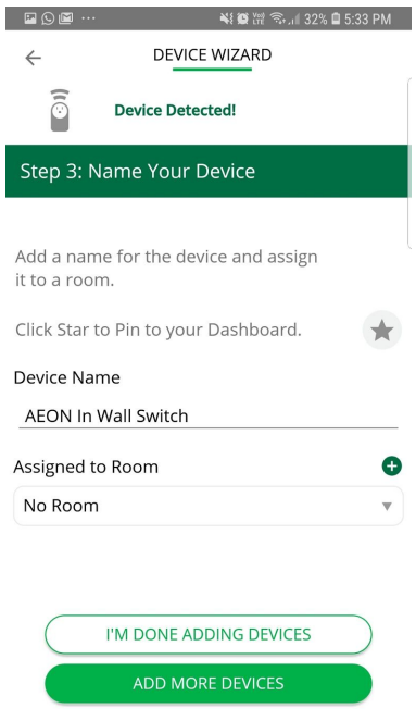

Follow the inclusion steps to pair the device. Once your device is detected, you'll get a
confirmation pop-up message on the screen, and then you can go on to assign a name and a
room for the device. You can tap on I'm Done Adding Devices to then wrap up the process,
after which point you will see your device in the Devices screen.
