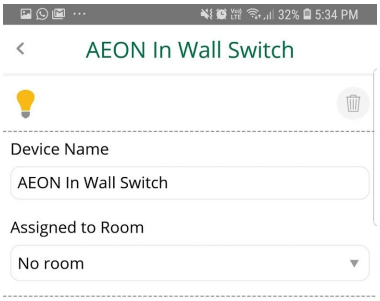

The unit can be taken to the exclusion by going to the device which is going to be excluded, then
tap on the trash can icon.

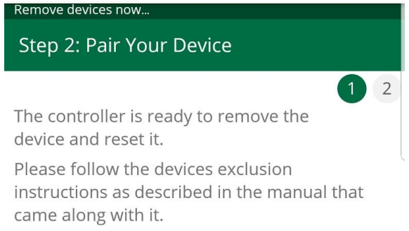

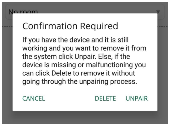

Select UNPAIR, which will set the controller into exclusion mode, you will see a message at the
top of the screen which says: Remove device now…
Unpair should be used if the device is still working and the user wants to remove it from the
system. Else, if the device is missing or malfunctioning you can click Delete to remove it without
going through the unpairing process.
Follow the instructions to exclude the device, after this process, the device will be removed from
the z-wave network and from the UI.
