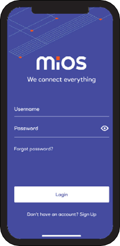

Log in or Create Account
If you already have an account, log in with your credentials, then go to “More” “My Controllers” and tap on “+” to continue adding the new hub to your account.
If you’re a new user, you can register by pressing on “Sign-Up” on the bottom of the screen, follow the steps to create your account, then tap on “Connect” to continue adding the hub to your account.

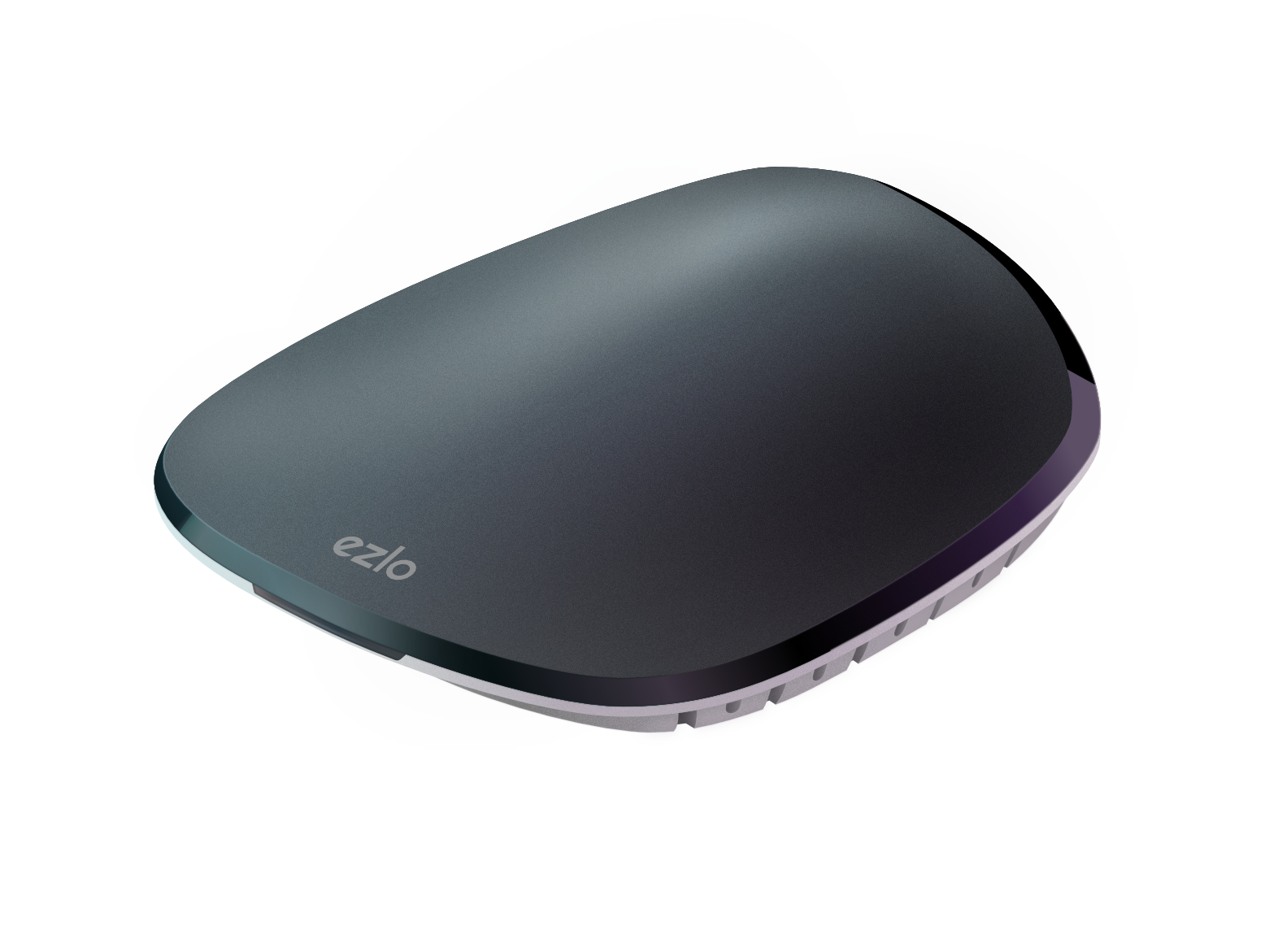

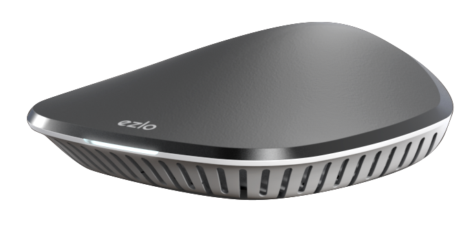

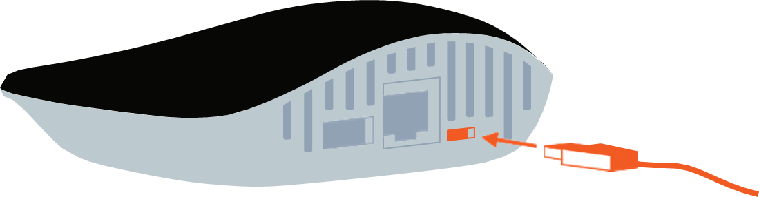

Power your Ezlo Plus
Next, connect the supplied A/C power adapter to your Ezlo Plus. Once it is powered on, the LED light should slowly change from green to dark blue, then amber.
Proceed to the next step when the light is fast blinking amber.

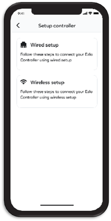

Connect your Ezlo Plus
The Ezlo Plus supports both wired and wireless setup. Select your preferred option and follow the prompts until you finalize the process.
