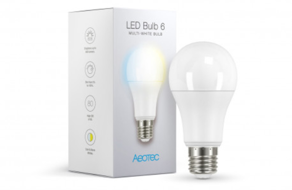

This guide outlines a straightforward process for pairing your Aeotec LED Bulb Gen 6 Multi-White ZWA001 with your Ezlo controller.
  • Connect the LED light bulb to an electrical outlet to power it up.
  • On the MiOS app, go to More > Devices, tap the “+” symbol, select the controller where you want to add the device, then go to "Generic Z-Wave device“ and tap "Next".
  • Tap “Next” again to start the pairing.
  • Power cycle once for led bulb (OFF->ON).The led bulb will flash twice.
  • Wait for the confirmation on your MiOS app and name your device.
Congratulations.
You can now conveniently control your bulb, adjusting Meshbots to achieve varying light intensities between 1 and 100%, and toggle the bulb on and off using the MiOS app.
