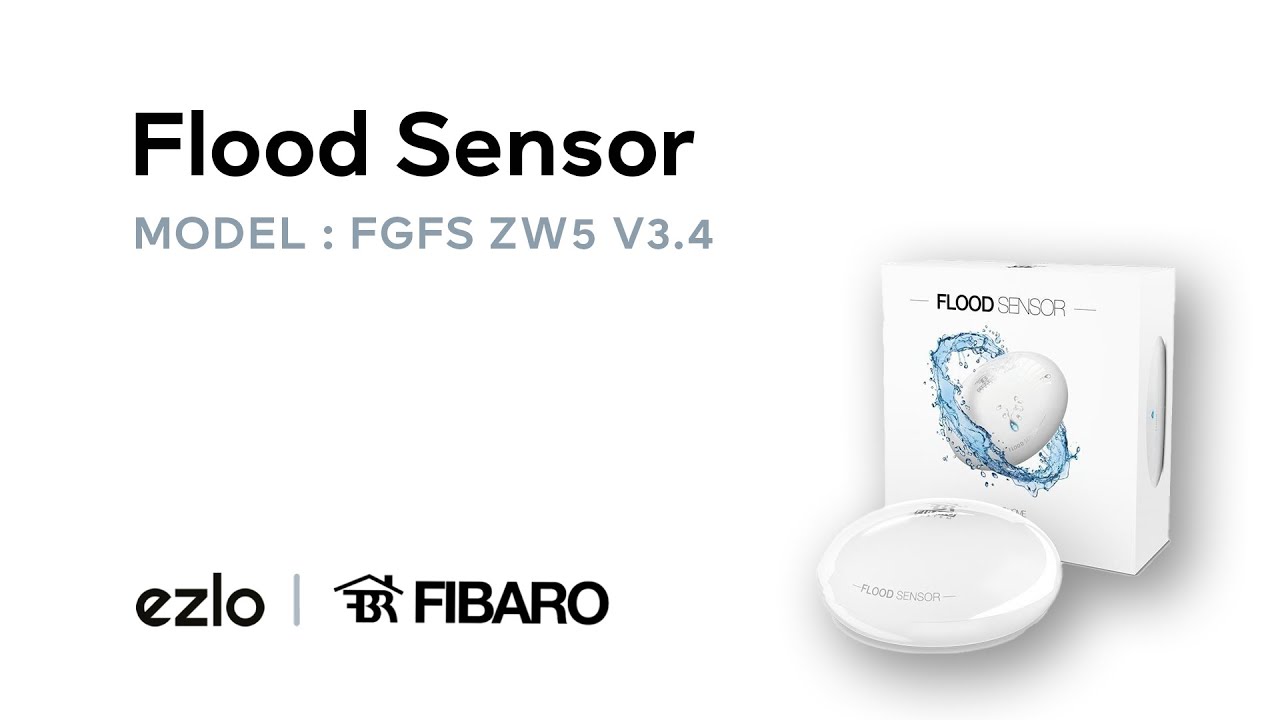

How to Pair a Fibaro Flood Sensor FGFS ZW5 V3.4
Sara
Sara
  • Updated
This guide outlines a straightforward process for pairing your Fibaro Flood Sensor FGFS ZW5 V3.4 with your Ezlo controller.
  • Open the battery cover of the sensor by turning it anti-clockwise.
  • On the MiOS app, go to More > Devices, tap the “+” symbol, select the controller where you want to add the device, then go to "Sensors" and select Fibaro Flood Sensor and tap “Next”.
  • Tap “Next” again to start the pairing.
  • Bring the sensor close to the controller.
  • Click the button in the sensor thrice.
  • Wait for the confirmation on your MiOS app and name your device.
