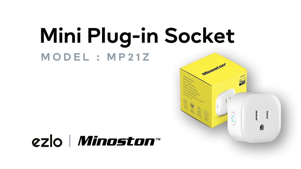

This guide outlines a straightforward process for pairing your Minoston Mini Plug-in Socket MP21Z with your Ezlo controller.
- Connect the Minoston Mini Plug-in Socket MP21Z to your electrical outlet.
- On the MiOS app, go to More > Devices, tap the “+” symbol, select the controller where you want to add the device, then go to "Generic Z-Wave device“ and tap "Next".
- Tap “Next” again to start the pairing.
- Go to the device and press the action button twice at the side of your device.
- Wait for the confirmation on your MiOS app and name your device.
Congratulations!
You can now use your MiOS app to control the Mini Plug and set MeshBots to turn devices On or Off according to your preferences.
