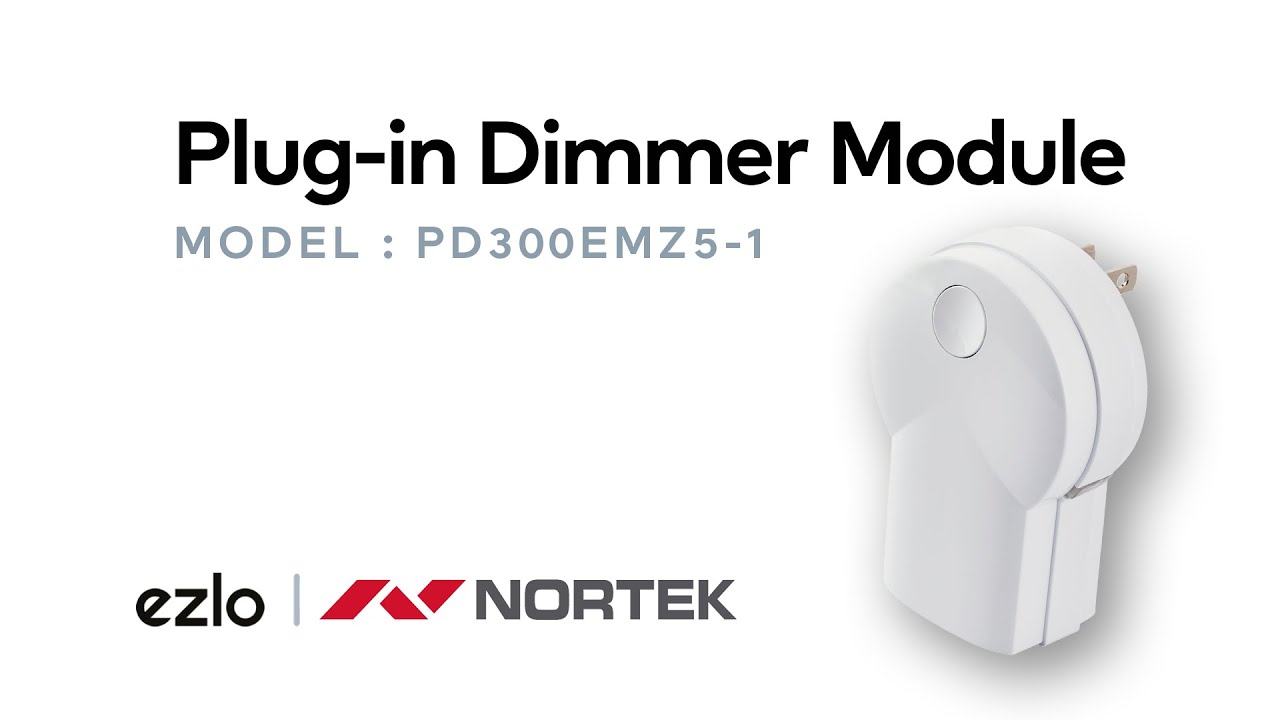

This guide outlines a straightforward process for pairing your Nortek Plug-in Dimmer with your Ezlo controller.
- Ensure your device is close to the controller for best results.
- Select where to place the dimmer and plug it into the electrical wall socket.
- On the MiOS app, go to More > Devices, tap the “+” symbol, select the controller where you want to add the device, then go to “Dimmers & Lights” and select your Plug-in Dimmer.
- Tap “Next” and begin the pairing process.
- Go to the Plug-in Dimmer and press the action button once.
- The dimmer will blink red, then blue for a few seconds to signify pairing.
- The controller and sensor will connect and pair up.
- Confirm and finalize the process in the MiOS app.
Congratulations!
You can now plug any appliance into your Nortek Plug-in Dimmer and remotely control it using your MiOS app. Utilize your MiOS app to switch on and dim your lights or create MeshBots to automate it.
