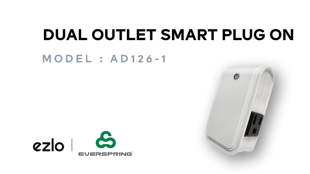

This guide outlines a straightforward process for setting up the Everspring Dual Outlet Smart Plug-On AD126-1 with your Ezlo controller.
- To begin, ensure the Everspring Dual Outlet is kept close to the controller for uninterrupted pairing.
- On the MiOS app, go to More > Devices, tap the “+” symbol, select the controller where you want to add the device, and then go to Dual Outlet Smart Plug ON.
- When you're ready to pair, click “Next” to initiate the process.
- Return to the Dual Outlet, plug it into the power source, and press the “action” button.
- Once your Ezlo controller detects the device, it will start the pairing process automatically.
- Finally, in the MiOS app, give your sensor a name and assign it to a room to complete the process.
Congratulations!
Your Everspring Dual Outlet Smart Plug ON AD126-1 is now ready to use. Simply plug your dimmer into the Outlet.
Now, use your MiOS app to switch on and dim your lights, controlling light intensity effortlessly.
