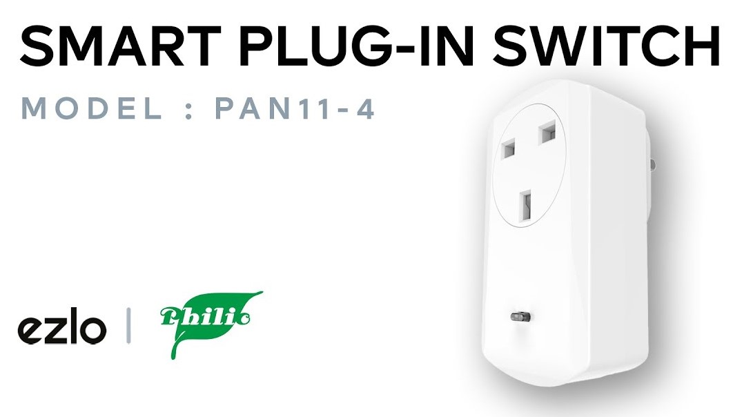

This guide outlines a straightforward process for pairing the Philio PAN11-4 Smart Plug-In Switch with your Ezlo controller.
  • To begin, find a suitable location to plug in the Philio PAN11-4 Smart Plug-In Switch and securely affix it to a wall outlet.
  • On the MiOS app, go to More > Devices, tap the “+” symbol, select the controller where you want to add the device, then go to the Smart Switch and tap on it to activate the pairing wizard.
  • Once the device is prepared, tap “Next,” and the pairing process will commence.
  • Return to the Smart Plug-In Switch, press the button twice, and wait for the controller to discover it.
  • Your Ezlo controller will then establish a connection with the Smart Plug-In Switch.
  • For optimal results, keep your Smart Plug-In Switch as close to the controller as possible.
Congratulations!
You've successfully paired your Philio PAN11-4 Smart Plug-In Switch with your Ezlo controller. Now you can plug a lamp into your Smart Plug-In Switch and control it from anywhere using your MiOS app. You can use the app to switch lights on and off, create MeshBots, and even utilize the Smart Plug-In Switch's action button for control.
