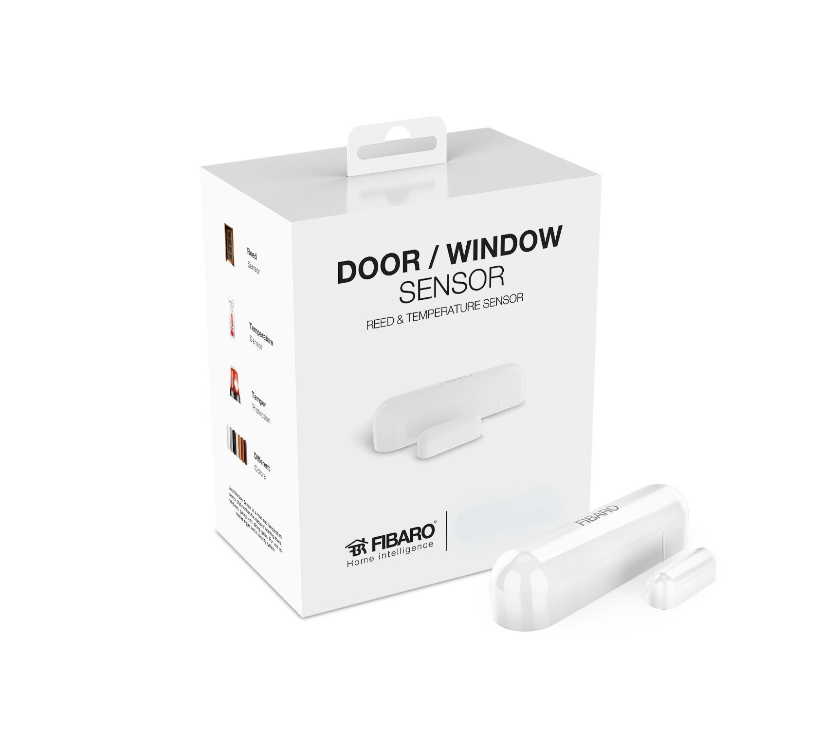

Pairing your Fibaro Door Window Sensor with your Ezlo controller is a straightforward process that only takes a few minutes.
  • Begin by opening the battery cover of the sensor. Remove the batteries to access the tab, and then reinsert them before replacing the cover.
  • On the MiOS app, go to More > Devices, tap the “+” symbol, select the controller where you want to add the device, and then go to “Sensors” to find Fibaro Door Window Sensor.
  • Select the Fibaro Door Window Sensor, and when you're ready, tap "Next" to initiate the pairing process.
  • On the Fibaro Door Window Sensor, press the back tamper button three times. As confirmation, the onboard LED will glow blue.
  • Once your Ezlo controller recognizes the device, it will pair it with your system.
  • Return to the MiOS app, where you can choose a name for your Sensor, assign it to a room, and complete the setup process.
  • Once done, you're all set to monitor the sensor using the MiOS app or trigger a MeshBot.
Now, you can use the MiOS app to monitor the Sensor and create MeshBots as needed.
