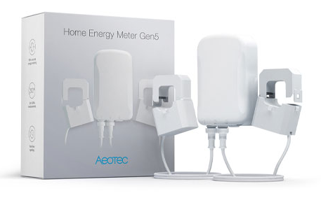

This guide offers a straightforward method for setting up your Aeotec Home Energy Meter and pairing it with your Ezlo controller.
  • The initial step involves installing the Energy Meter onto your energy mains and connecting it to the power source.
  • On the MiOS app, go to More > Devices, tap the “+” symbol, and select the controller where you want to add the device.
  • Proceed to the "Energy" section, locate your Energy Meter, and tap on it to initiate the pairing wizard.
  • Once you're ready to pair, tap "Next" to begin the process. Then, return to your Energy Meter and press the action button once to allow your Ezlo controller to detect and pair it.
  • Back in the MiOS app, choose a name for your Energy Meter, assign it to a room, and complete the setup process.
Congratulations, you're all set to go.
You can now trigger MeshBots with your Aeotec Home Energy Meter and the MiOS app.
