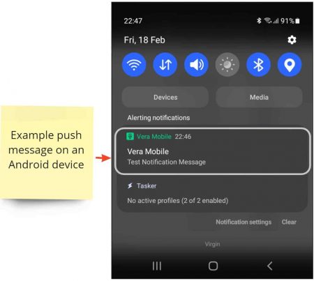

Push – Sends a message that pops up on the selected user’s phone if they have the Vera app installed. Push messages have a similar appearance to regular text messages but only appear if the Vera app is on the device:

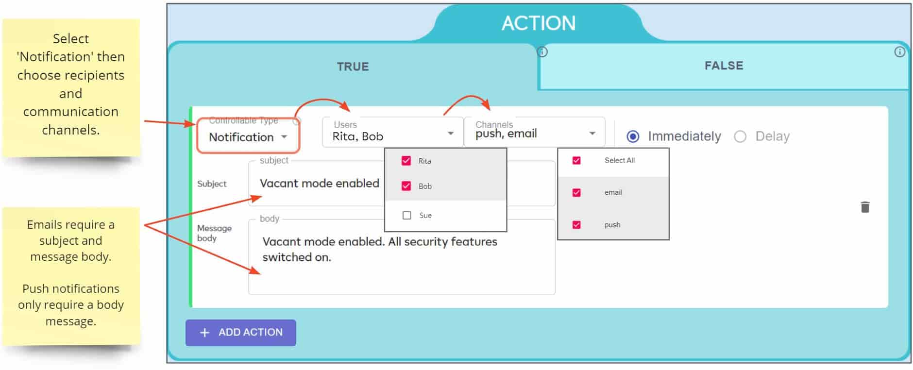

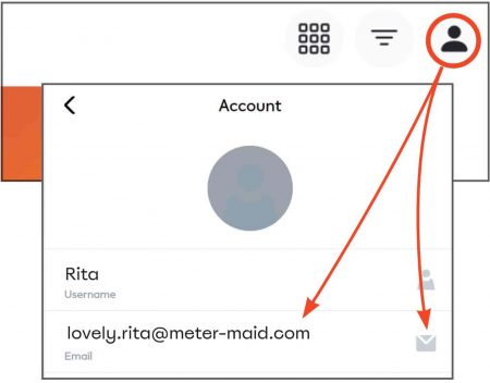

Email – Sends an email to the people selected in the ‘Users’ drop-down. You can send the mail to the address of the currently logged in user plus any secondary users that have been added to the Vera mobile app. You can view and edit your account email address by clicking the user icon at the top-right of the EZlogic dashboard screen:
Users – You can send notifications to the email addresses and/or mobile devices of the account admin and any secondary users.

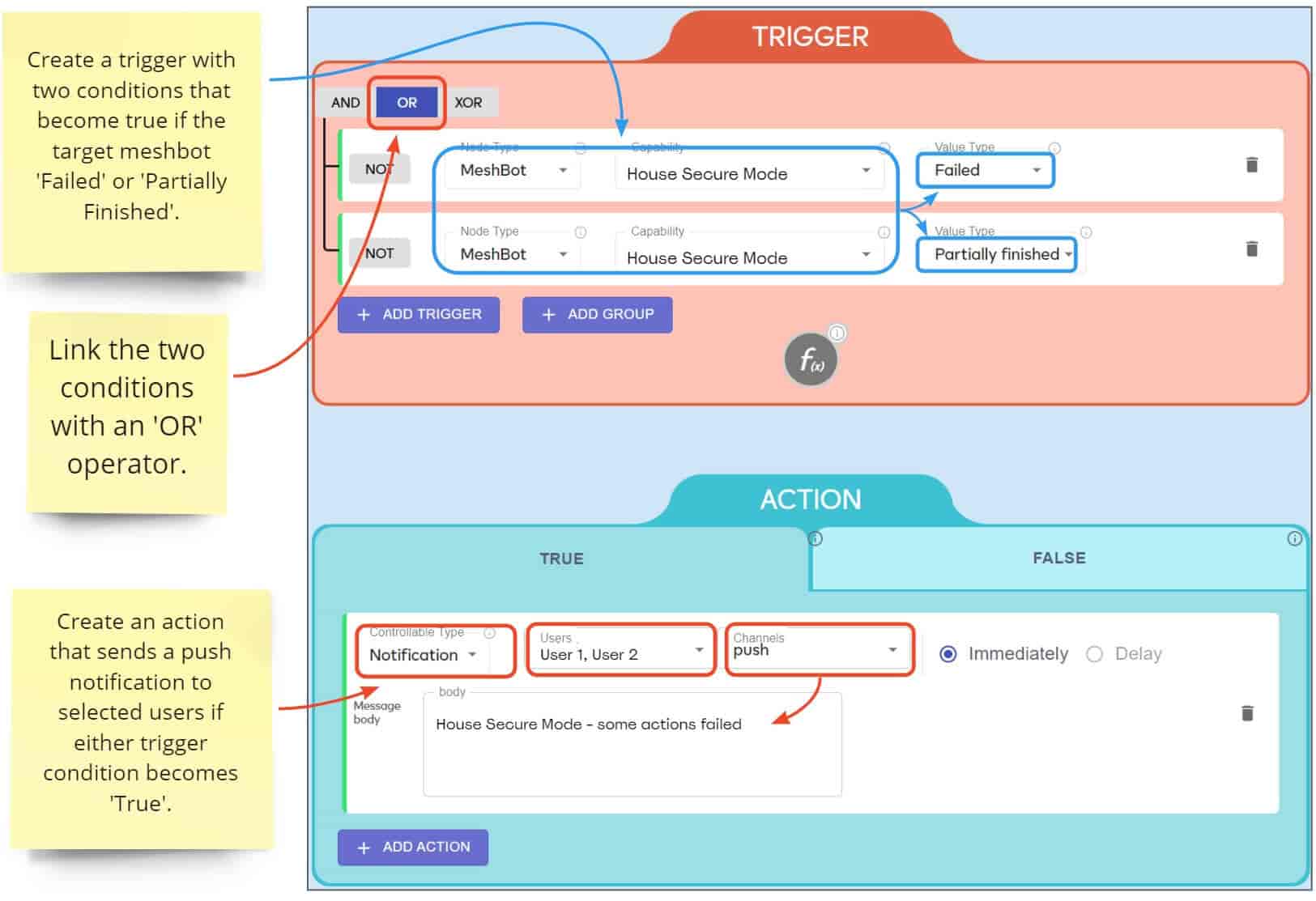

  • You have an existing meshbot called ‘House Secure Mode’. The actions in the meshbot lock all your doors and windows and enable security devices such as motion sensors, burglar alarms, and so forth.
  • You want to be notified by push notification immediately if any of these actions fail to complete.
  • You can achieve this task by setting up another meshbot as shown below:

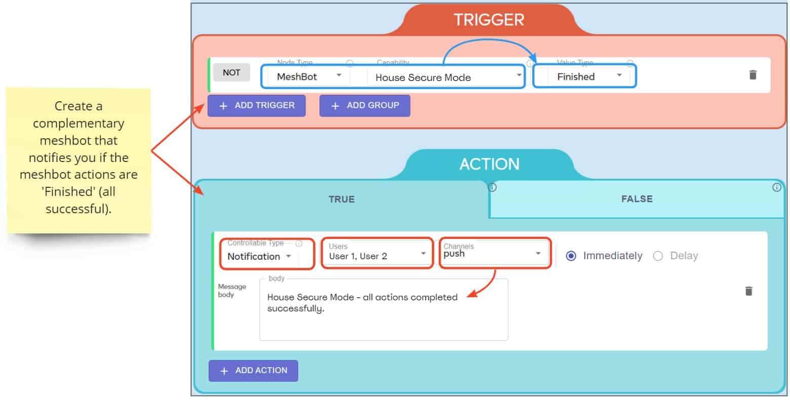

  • Optional. Create a second meshbot that notifies you if ‘House Secure Mode’ was successful. This reassures you that, not only did the meshbot run, but all its constituent actions engaged correctly:
  • The above is ‘optional’ because you could just assume the meshbot was successful if you did not receive the ‘fail’ notification from the first meshbot.
