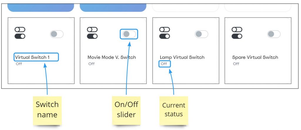

  • The new devices automatically appear in your dynamic dashboard as shown below:
