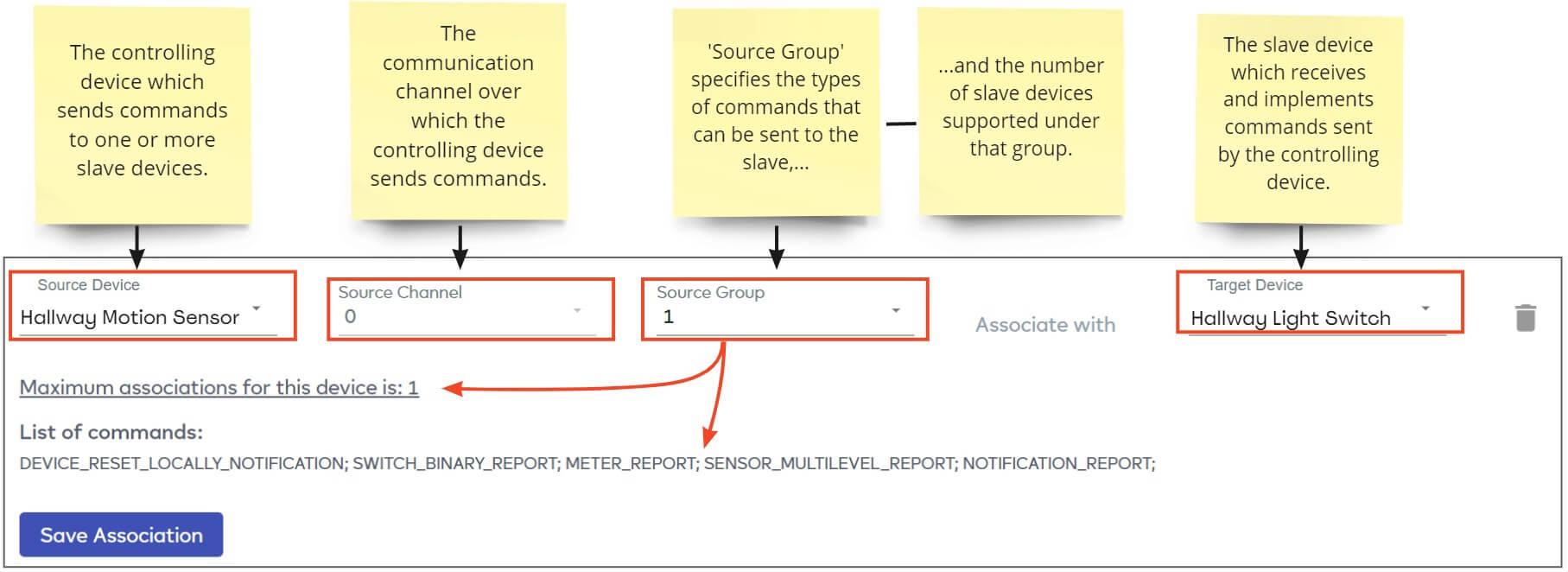

Device associations let you create direct communications between two or more Z-Wave devices without the need for a central hub/controller. One device acts as a controlling node which sends commands to one or more receiving, or ‘slave’, devices.
For example, you could set up a motion sensor (controlling device) to turn-on a light switch (slave device) whenever it detects movement:
  • You must have paired your devices with an Ezlo or Vera controller in order to create an association between them in EZLogic.
  • You can only associate Z-Wave devices with each other. You can’t, for example, associate a Z-Wave device with a Zigbee device.
  • Not every Z-Wave device supports association. Check the manufacturer’s documentation if you don’t see a particular device in the ‘Source’ or ‘Target’ drop-down menus.

Association groups

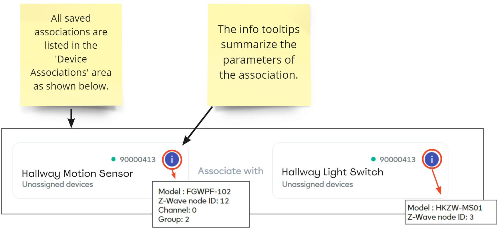

  • An association group is a list of device IDs stored on a controlling (source) device when you create an association in EZLogic. The controlling device will send a command or notification to all devices in the list when certain conditions are met. For example, a motion detector could send an ‘On’ command to a light switch device when it is tripped.
  • The group number determines the type of commands that can be sent from the source device to the target device. The group number must be available on both devices and it must support the same type of commands. For example, if group 3 on a light switch is the group that sends dimmer commands, then group 3 on the target device must be capable of receiving dimmer commands.
  • Groups are not ‘global’ – they are specific to each device. The number of groups supported by a device, and the commands within each group, varies by device and manufacturer. Please check the device’s manual to find out which groups it supports (if any).
    • For example, group 4 on one device might have a completely different set of commands to group 4 on another device. This means you can associate device ‘A’ with device ‘B’ over group 4, and also associate device ‘C’ with device ‘D’ over group 4. The two operations will not interfere with each other.

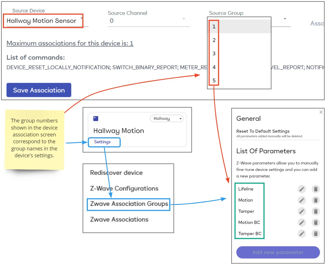

  • Group 1 is usually called the ‘lifeline’ group and is for communications between a device and a central controller. The group lets the device report basic information to the controller, like its battery level, on/off status and other details.
    • Group 1 is generally not used for direct associations between two devices. If you want one device to send a specific type of command to another then you should consider group 2 and upwards.
  • Group 2 is a good starting place if you just want one device to send On/Off commands to target devices. Most device manufacturers use group 2 to send or receive Basic_Set On/Off commands.
  • You can find the names and number of groups that a device supports by clicking ‘Settings’ on its tile in the ‘Devices’ area:

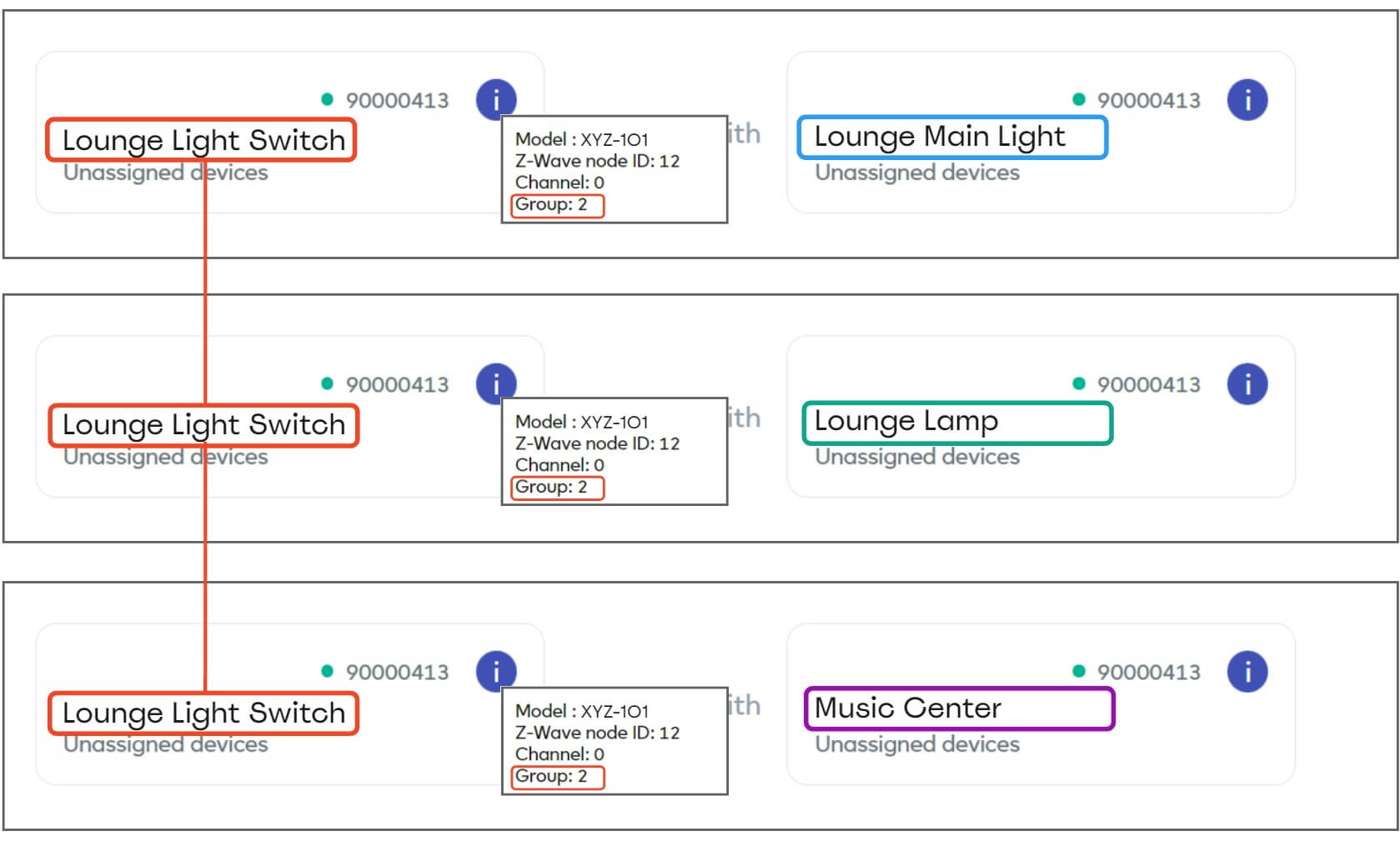

  • You can associate a single controlling device with multiple target (slave) devices. For example, to have a switch turn on your lounge main lights, a lamp, and your music center.
    Simply create a separate association for each target device and use the same source group for all three:
All three target devices will receive the On/Off command from the switch at the same time.
