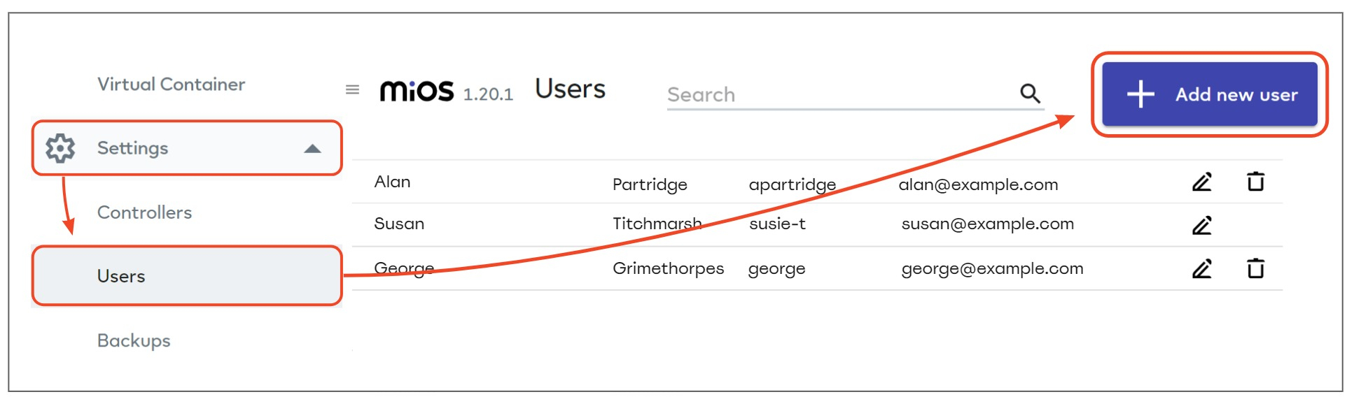

Add, remove and edit users
- Log into EZLogic
- Click ‘Account’ > ‘User Management’
- Click ‘Add New User’:
- Complete all fields in the new user form. Passwords must be at least 8 characters long and contain at least one uppercase and lowercase letter, a special character and a number:
- Click ‘Save’ to create your new user. We will send an account verification email to the email address you provided in the new user form.
- Users must click the validation link in order to login and use EZLogic or the Vera app:
- New users appear in the list as follows:
