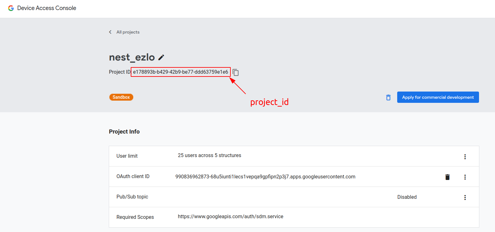

Once you follow the steps in the linked guide and create your project, go into the details of the project and note down the Project ID.

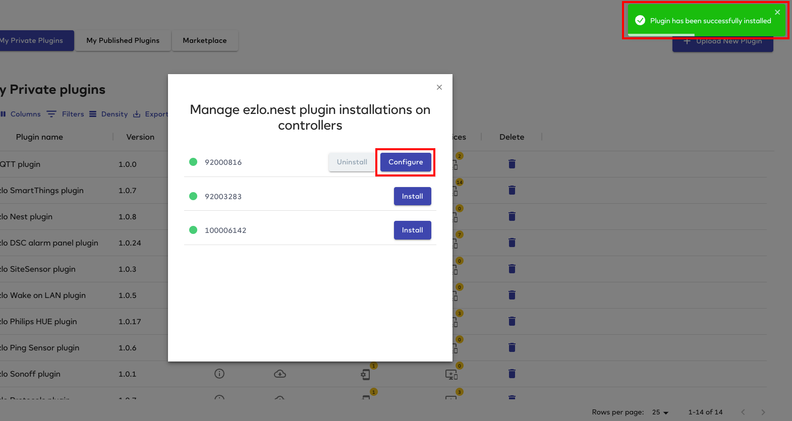

What follows is copying the plugin to your Ezlo account from the plugin marketplace and installing it on your controller. To do that, navigate to the Edge Plugins menu on EZlogic, then to the Marketplace. Click the “Copy to my Ezlo” button for the Nest plugin. Once you’re taken back to the “My Private Plugins” tab which now includes the Nest plugin, click the Manage Installations button and click the Install button next to your controller.
Once you do that and you see the success message, click the Configure button.
