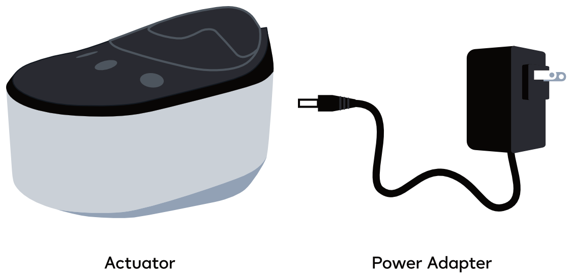

What's in the Box

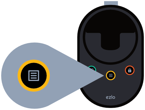

  1. Follow the manufacturer's instructions to set your Smart Home Z-Wave Hub into Inclusion mode to add the Water Valve.
  2. Press the 'Include/Exclude' button once on your water valve. The LED light will blink orange during the inclusion process and stop when finished.
  3. Continue with the inclusion process from your hub to complete the installation.

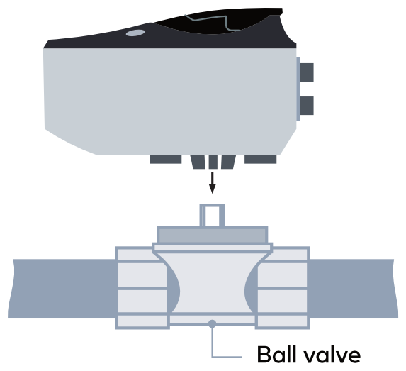

4. Connecting the Actuator to the Ball Valve

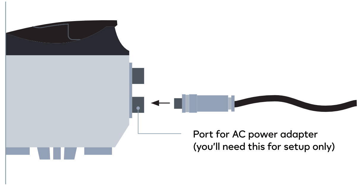

Once the ball valve has been plumbed into your home’s water system, disconnect the Smart Water Shut-Off Valve from its AC power cable and snap it into the ball valve. Then reconnect it to a nearby power source.
If your Smart Water Shut-O Valve is outside or plumbed away from a power source, you may need to use an extension cord.

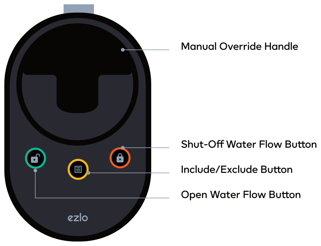

Reset to factory settings
To reset the Water Valve, press the Include/Exclude button for over 10 seconds. The LED ring will start blinking orange. The valve will send a "Device Reset Locally Notification" to the hub it was included on.
